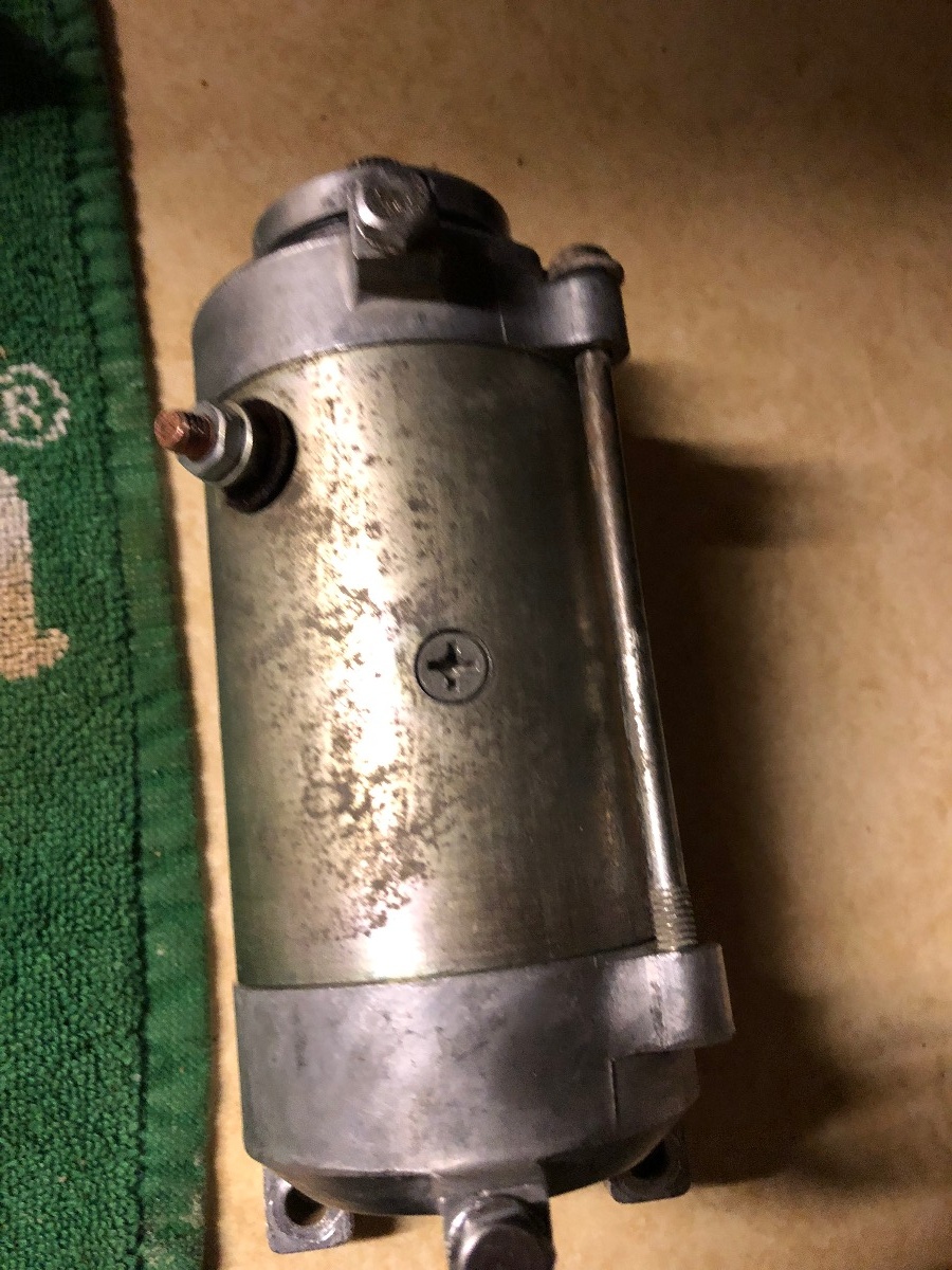

- Jack_Mills
- Posts: 165
- Thanks: 17
Re: 1980 Kz750 LTD dreaded starting noise
20 Jan 2018 04:47
Hey I used to have that noise on my 75kz400. Even got as bad as spinning without engaging the starter + the noise. How I fixed it was pretty simple. The starters on these (or starters in general) are fairly easy. I took mine apart (carefully noting where the washer shims go, etc). On mine, theres only one lead that needs disconnected to the brushes. From what I see (Ive redone my 75, 76 and 77 starter now) there is a yellow haze that forms on the metal connections, causing poor connection (and that horrible sound). This may sound cray, but I simply put the pieces of the starter in the parts washer and scrubbed everything (yes everything). I did take extra care not to soak the main spinning coil part. I dried them very very good with an airgun. (pretty important obviously). Then I took some fine sandpaper and cleaned all the plates and end of the brushes. Let sit overnight. Next morning, hit all the parts again with the airgun to make sure there is no more liquid hiding somewhere, and put it back together. Hooked it back up to the 75, and the sound was gone. As I mentioned I did this to two more identical starters since, and all 3 had that nasty sound/issues with engaging. Now all 3 work like they should with no problems.

I also did this to my 81kz440, and its working great now.
