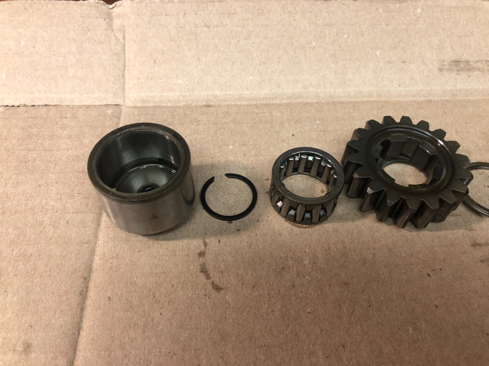

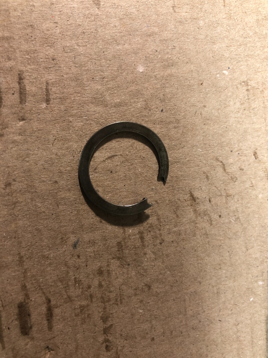

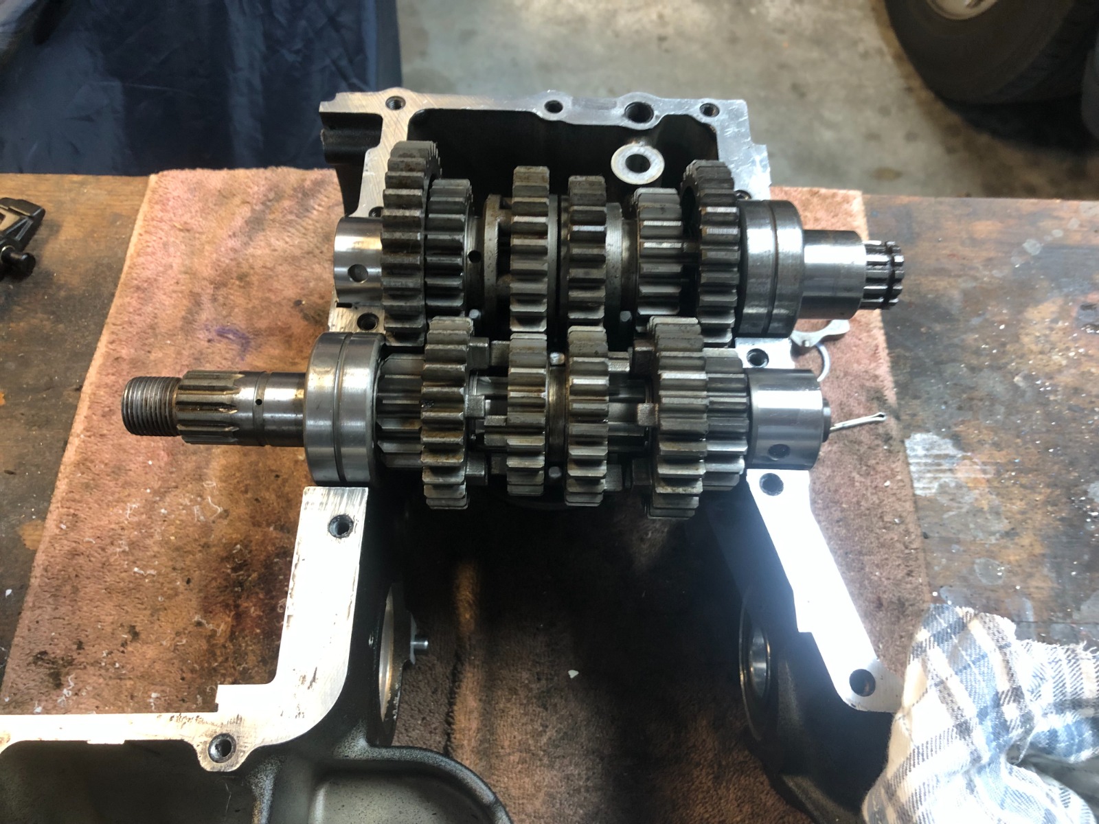

So, getting back to this after a long delay. I have been test fitting the transmission and I would like to point out the 750 roller bearing has to be used with the 750 input bushing. It's NLA but I was able to find NOS on eBay. It's fairly obvious but should be pointed out since you have to remove it from the 750 cluster. I missed it when I was putting things together for test fitting. The attached pic shows the correct needle bearing the 550 needle bearing is smaller. Also, what tool should be used to take these circlips on and off without damaging them?
