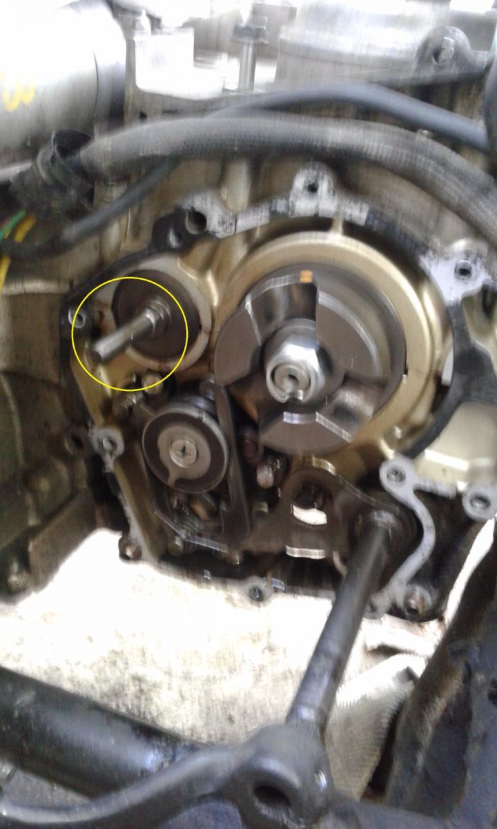

What is this (circled in picture)

I would say the clutch push rod.

You can get the part number from Partzilla and then either order there or try ebay.

18 Nov 2017 20:26 - 18 Nov 2017 20:32Scirocco wrote: I would say the clutch push rod.
Confirmed.
On my kz1100 the part number is 13116-1007. Looks like it is common among several models. A quick ebay search resulted in a few hits each around $40. No luck with Partzilla, looks out of stock
