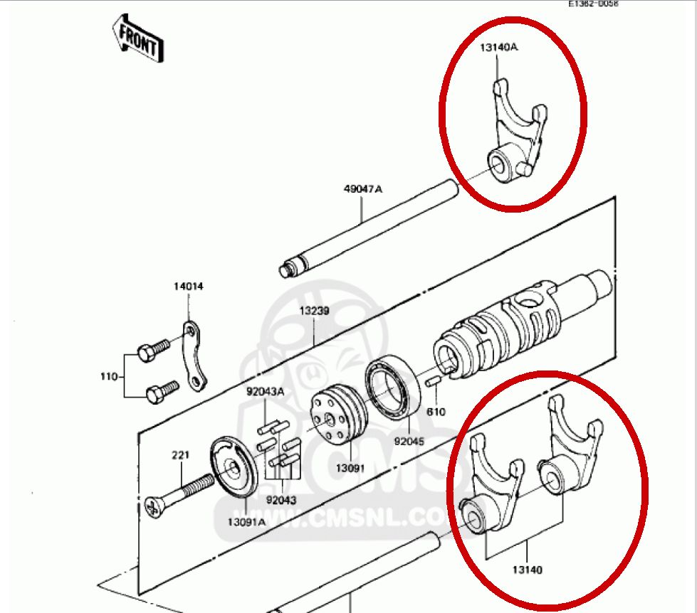

1982 KZ1100 Spectre............Any difference in shift forks other than the obvious 4th 5th gear fork?
Re: Any diff in shift forks BESIDES the 4th 5th fork?
11 Nov 2017 00:07 - 11 Nov 2017 00:14
No difference for the 4th 5th gear shift fork part #13140A.
All other gears use shift forks part #13140.
All 1100 ccm engines (1981 - 84) use the same shift forks.

Wow man, so glad I didn't decide to use the shift forks from a wrecked 86 ninja. Y'know, I did ask the question "Any differences between 82 and 86" on this forum, however, that post went unanswered
Oh well, hey bro ...Thank you for the additional information. I do appreciate it.

Seriously? I bet nobody here even imagined you were asking about ZX600 shift forks. That is a completely different engine and transmission from what you have.
On the other hand, the 1986 KZ 1000 uses the very same shift forks as your 1982 KZ1100. It took me about a minute or minute and a half on Partzilla.com to see all the different models that use those forks. You might want to give it a try sometime.
