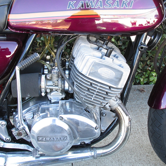

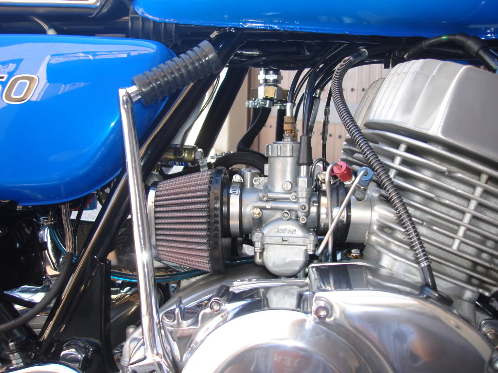

Have you try a kick start lever from a Kawasaki 750 H2 triple? It looks like they are little bit longer and have a better leverage you want.
Kawasaki 750 H2 with Z1 kick start lever.
