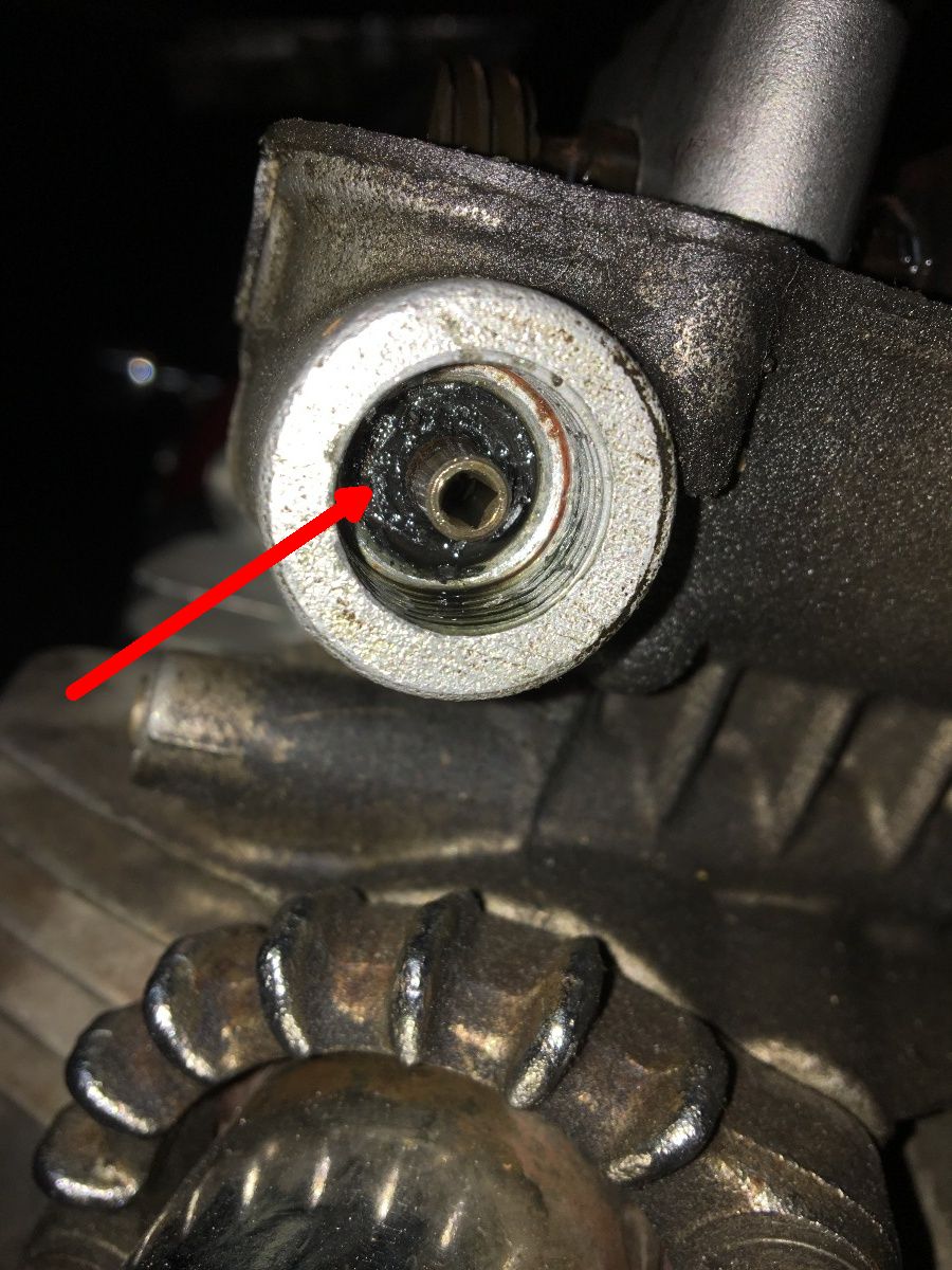

There is no mechanically lock.
The drive gear will only be hold in place by the black oil seal ring.
A little force to pull or push the gear out is necessary

Thanks for responding. What about the housing itself though (the metal socket around the seal)? Here’s a photo of the replacement for reference.

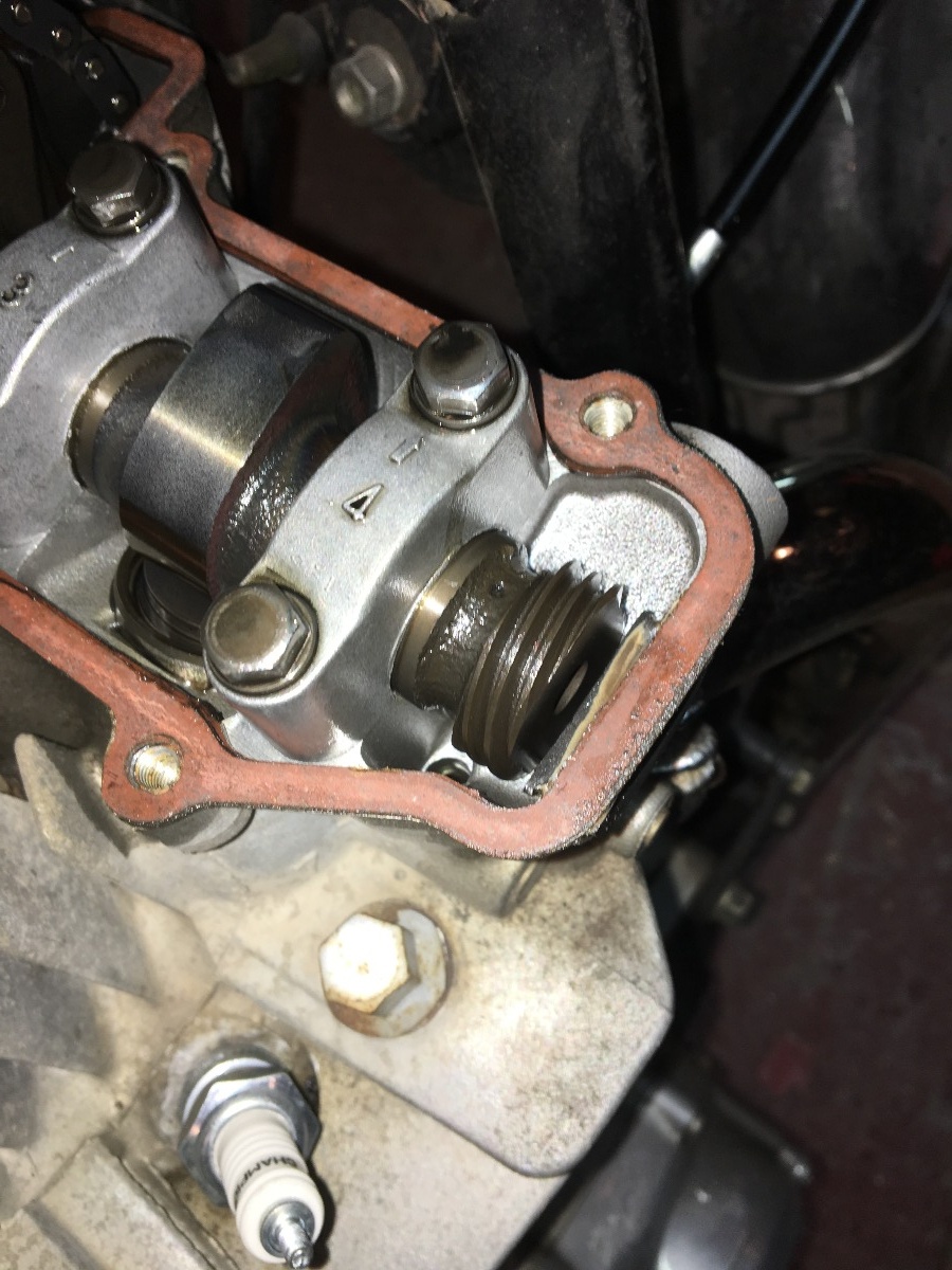

In your second picture it looks like someone has been in there before, there appears to be some red stuff around the edge of the unit, this would make it hard to remove.

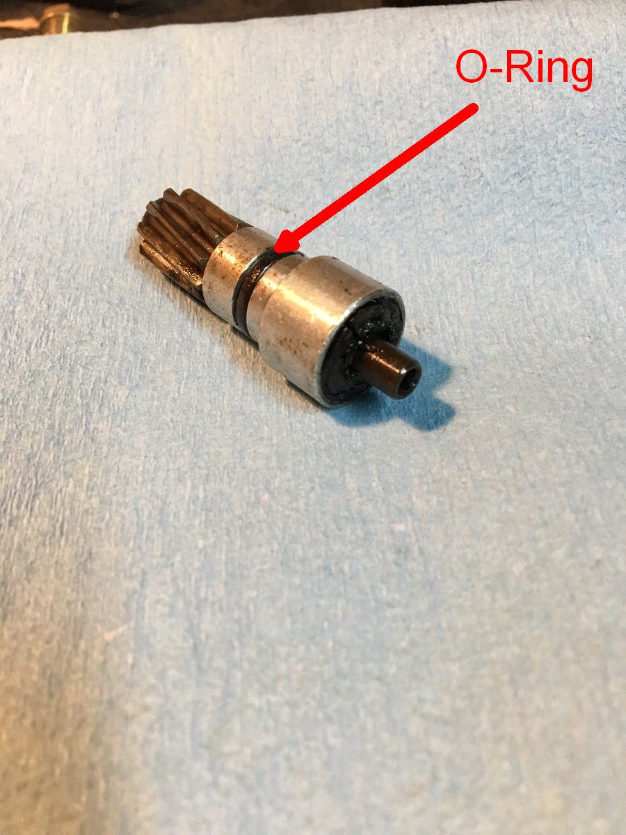

O-Ring seals housing and cylinder head bore

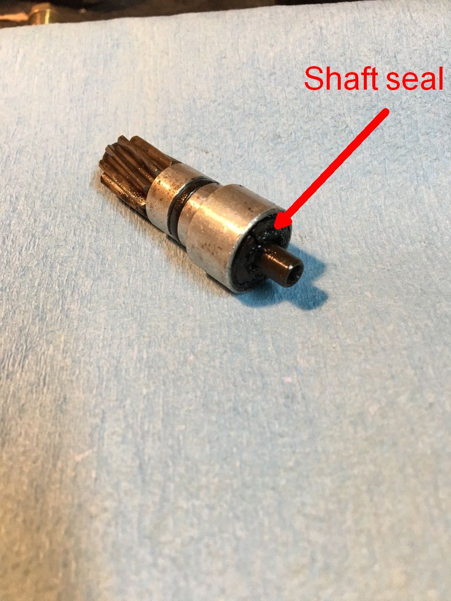

Shaft seal

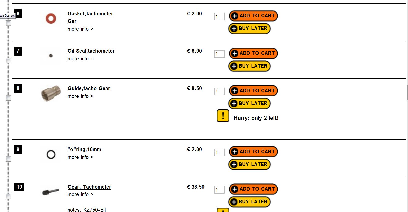

www.cmsnl.com/kawasaki-kz750b4-1979-usa-...t/57930.html#results
Michael
