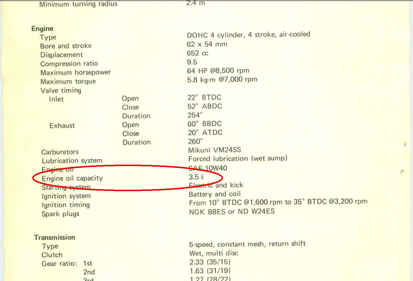

I saw online that the bike is supposed to hold 3.8 liters of oil (it's a 3500cc capacity).
maintenance.kz650.info/GeneralMaintSpecs.htm
However when I drained the oil only maybe 1 or 1.5L came out.

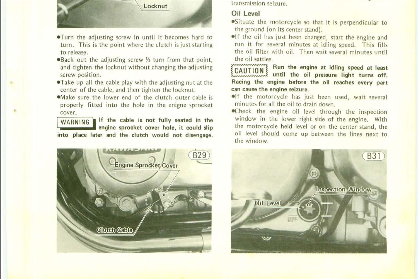

Oil change with new filter 3,5 liter = 3500 ml
Oil change without new filter 3,2 liter = 3200 ml
Are you sure you have calculate in metric volume units?
Bike straight on the ground or on the center stand, NOT on the side stand, to control the max. or min. oil level in the peep hole.

Yes I am sure I calculated in metric volume units, and I did check with the bike straight on the ground.
The mechanics from the garage next door were also stunned by the volume difference between reality and the theory.

Did you drain the oil while on the center stand? If not and on the side stand you would have not got all of the oil out......... I changed my oil and filter yesterday and 3 quarts and 12 oz out of a 4th got me about 3/4ths of the way on the sight glass ....... and no you see no oil looking in the oil fill hole as its at the bottom of the cover.

Did you start the bike up then check the oil? The new oil filter will suck up some of the oil.

I did the oil change on the centre stand and then moved the bike in all kind of positions to empty it completely.
I also opened the sump cap.
I then started the bike and let it run for a couple minutes for the oil to run through the engine.
After all this, still looks like im full with these almost 2 litres.
