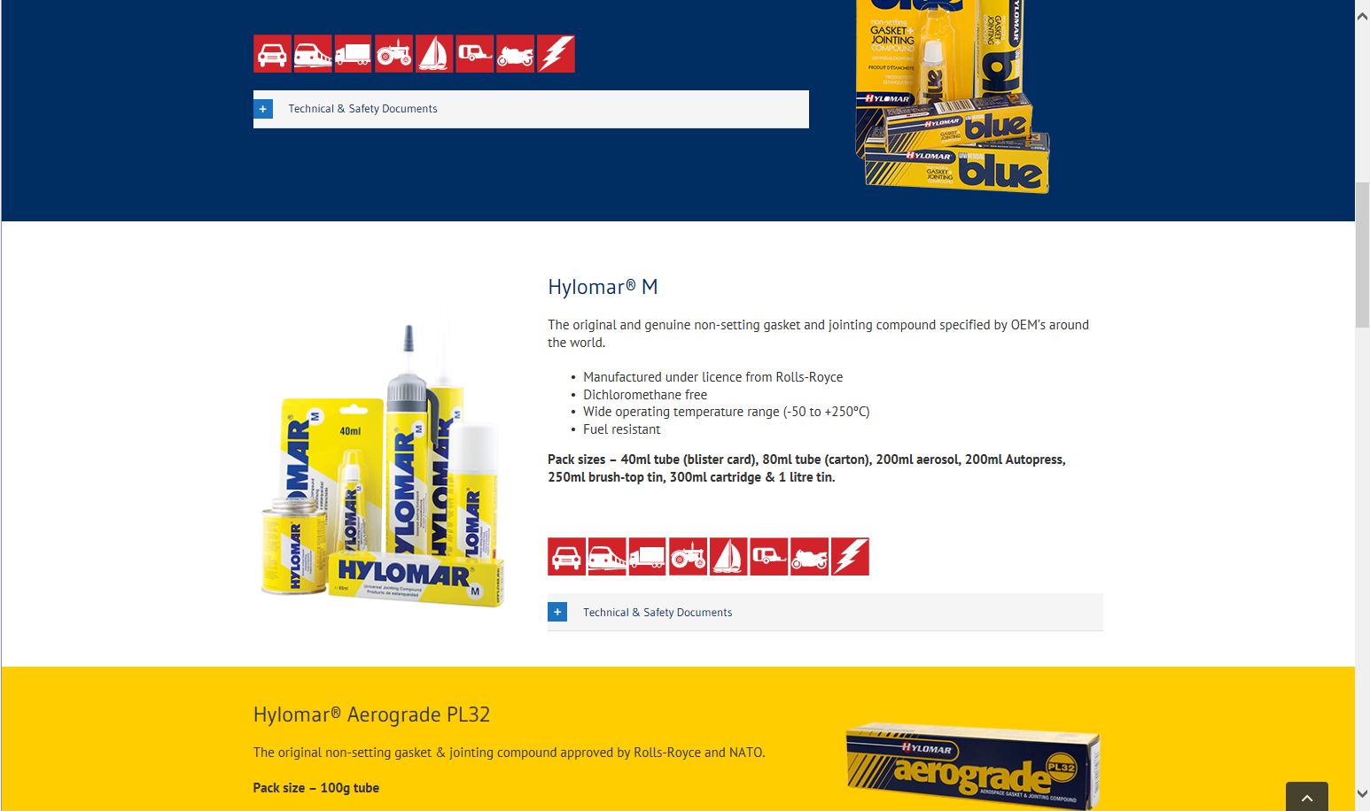

Cam end plugs and valve cover gasket don´t need any sealant but a very, very thin layer of non-curing sealing compound don´t hurt.
I prefer and use Hylomar M (Blue)
