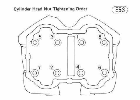

Re: Head Gasket questions
09 Oct 2017 12:12
With the valve cover removed I believe the 8 cylinder head nuts will be very easy to spot. The Kawasaki Service Manual shows the tightening sequence below. Ed
- Smallzphoto
- Posts: 58
- Thanks: 12
09 Oct 2017 12:56
Ok Cool! Thanks for this!
It seems as if the previous owners of this bike phoned it in when it came to nuts and bolts so I wouldn't be surprised if they were loose. I just found 2 stripped exhaust studs a few mins ago too haha.
I appreciate all the help!!!!
