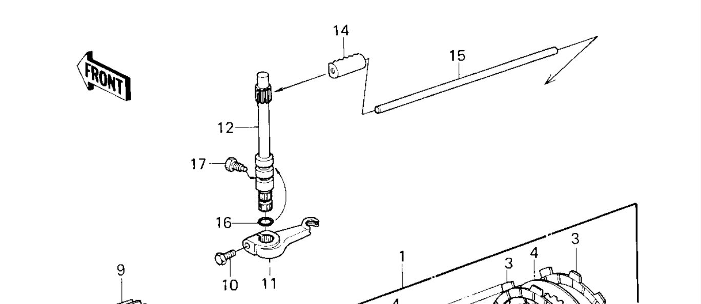

The KZ250 clutch release is different from most KZs, but it's kind of similar to some of the shaft drive models. With that type you usually adjust the cable & if that doesn't work the cable may be stretched so you'd replace the cable. This is assuming the clutch release mechanism is properly installed & not damaged.
I don't know anything about the 250, but from the diagrams at Partzilla, the clutch release lever mates to the clutch release shaft. check that the splines aren't stripped & make sure the bolt is tightened properly. There's another bolt that appears to be a dog bolt. The end of the bolt fits into a groove on the clutch release shaft & I think it keeps the shaft from moving up & down.
There's a long push rod & a short push rod. The short push rod has teeth that mesh with the clutch release shaft. make sure the teeth on each part aren't worn or broken. Maybe the short push rod is missing?

Okay martin_csr i will try to locate these bolts and i cant find the short push rod does that go infront of the long one or do you know where i can find it?

01 Oct 2017 13:26Kawi-problems23 wrote: Okay martin_csr i will try to locate these bolts and i cant find the short push rod does that go infront of the long one or do you know where i can find it?
The release mechanism is numbers 10 - 15
www.kawasaki.com/Parts/PartsDiagram/142237/1980/KZ250-D1

Re: Clutch
01 Oct 2017 14:53 - 01 Oct 2017 15:03
The KZ 250 D1 has a unique clutch actuator gear push rod system, this is Kawi-problems23 mayor problem.
my thought is:
He has to adjust the gear on rod #12 with gear push rod #14.
Loosen screw #17, pull out #12, push in #14 to get in touch (pressure)push rod #15 and then put in #12 to a 90 - 100 degree angle.
or readjust lever #11 on rod #12
my thought is:
