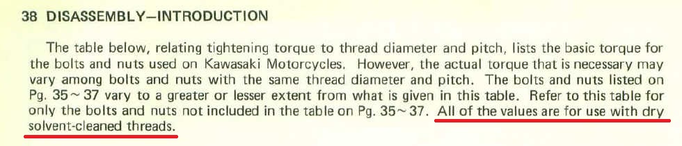

NO - you do NOT lubricate the fasteners.
If you have not done so I would urge you to buy and carefully read the Kawasaki Service Manual for your specific bike before proceeding any further. The folks who wrote the manual did so with a sound understanding of the bikes, so it is best to adhere to their instructions.
When installing fasteners you should use an appropriate torque wrench and follow the instructions for the correct torque level in the manual. Also, you should follow the other instructions in the manual such as the ones shown below:
