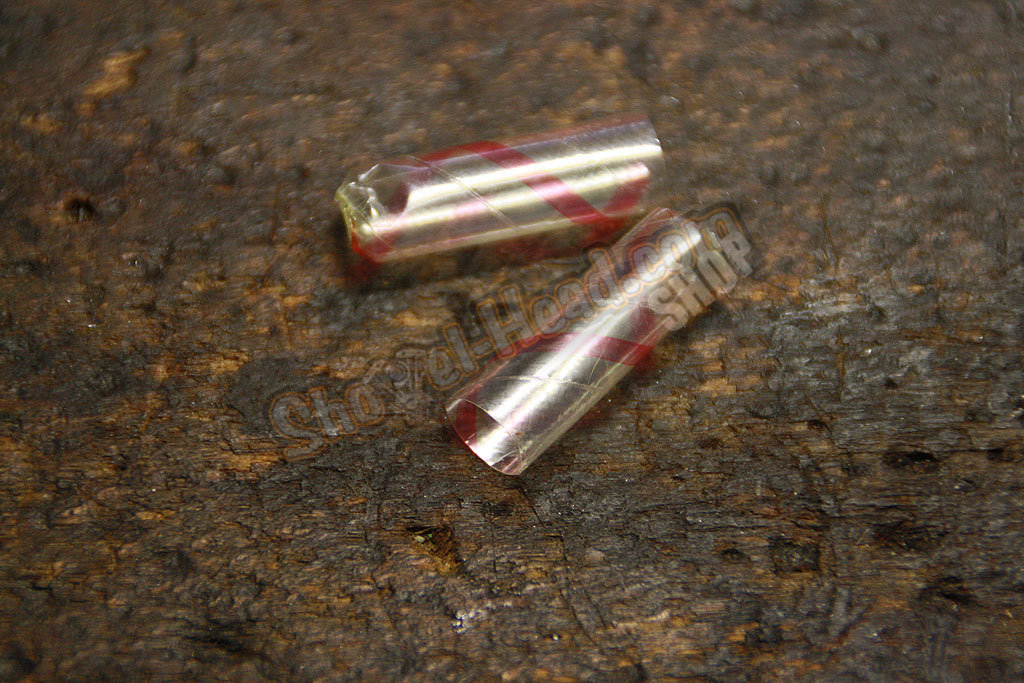

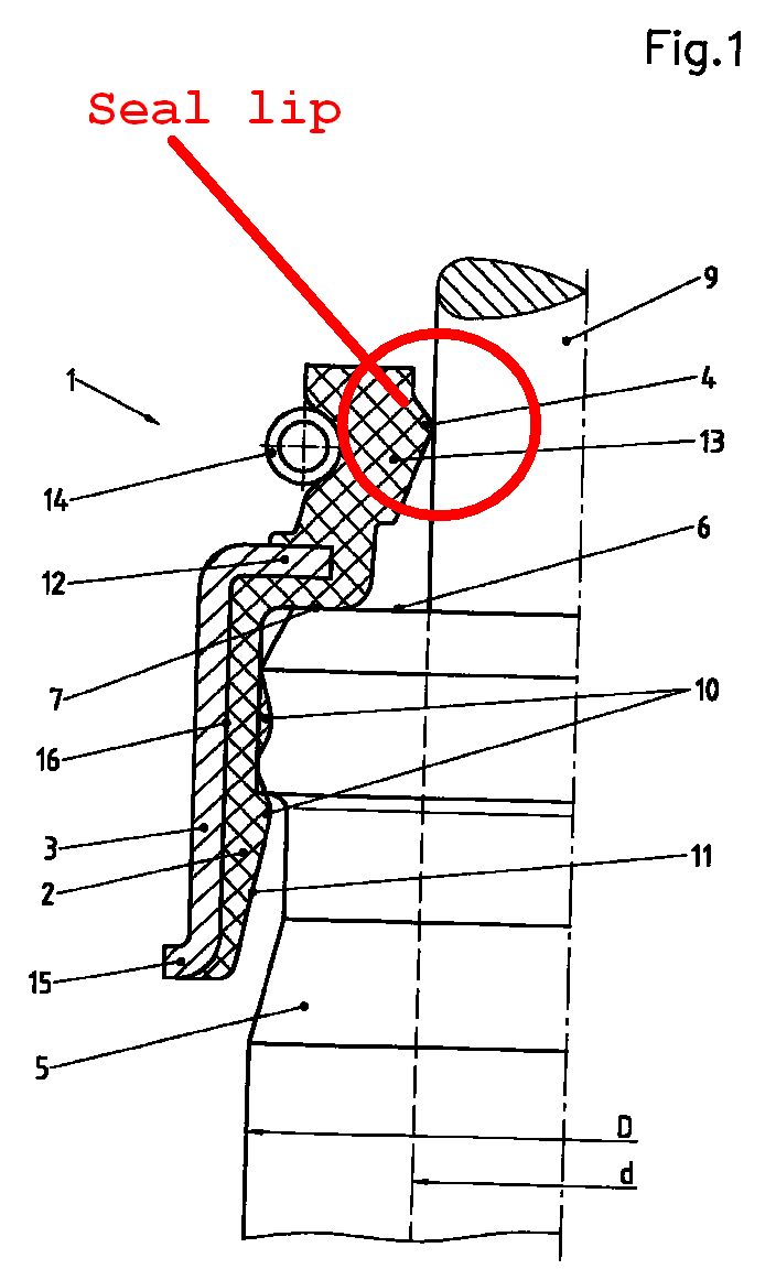

Smoking on deceleration = vacuum in the combustion camber = sucking oil over valve stem guides/valve seals.
A fundamental error is installing new valve seals without protection of the thin valve sealing lip.
You have to use a plastic tube (condom) to protect the valve sealing lip during the install.
The valve keeper key groove can damage the very small sealing lip easily during the install without the tube.

Hey thanks for that, no never used a condom which has proved costly as a younger man and perhaps is costing me again
Just dipped the seals in oil and lubed up the shaft and slipped over carefully, could have damaged I guess.
Is there any test I can do without having to tear down again?

Yes the seal lip can be damaged and not must be with a lot of oil during the install.
It is dependent of the engine mileage,, the oil returning rings on the piston can be end of life too and let pass the oil on deceleration.
