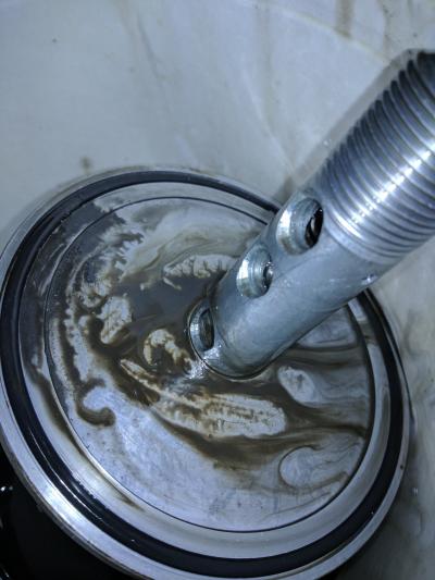

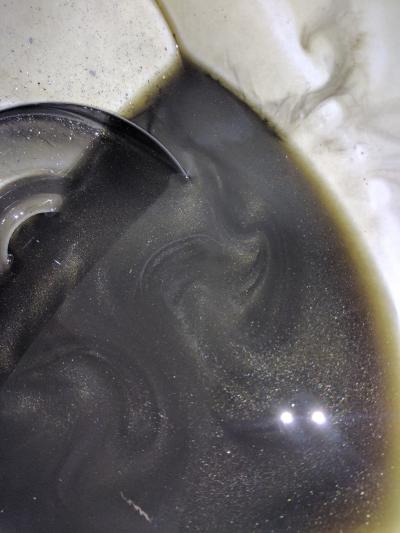

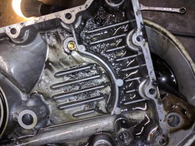

ding ding ding! we have a winner I think. Pulled the oil pan.....
uh oh...
shit shit shit
thought so.

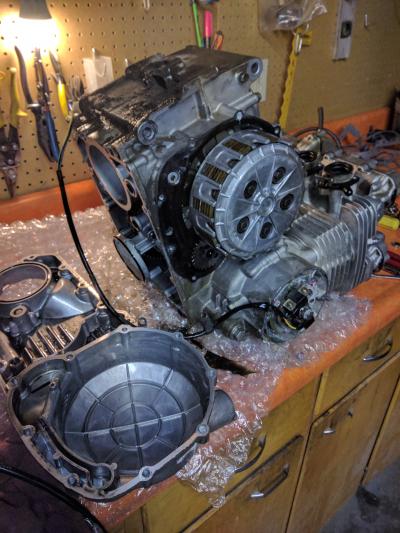

might as well pull the motor.....
i'm guessing it was a rod bearing/crank bearing locking up that caused the sudden seizing of the motor.
So! thoughts on where to go from here? I'm now at the point where it would have been cheaper just to buy a running motorcycle (got this for $175), but its too late for that. First thought was to pull the crank figure out what went wrong and have it checked over / machined and get new bearings. I'd pull the head as well just to verify that the valves are ok.
- Posts: 8205
- Thanks: 3577
Re: Knocking noise on 82 kz550 LTD C3
07 Sep 2017 05:27
You can't machine one of those cranks. There are no undersized bearings available. It shouldn't be overly hard to find a good used crank though. You gotta pay attention to the marks on the crankcase and the marks on the crank and then order the proper size/color bearings. The FSM details what's needed in that regard.
