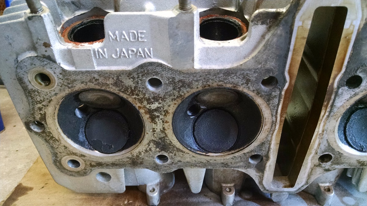

Hello to other kz riders. I am in the process of fixing the notorious head o-ring oil leak / seeping that seems to plague my 36 year old kaw, since I got it running / restored it. (it was an abandoned vehicle I bought off of CL, no title, no keys, no running, etc). I had been tucking rolled up shop towel pieces for the Kotex effect on the head oil leak / seep while waiting on a chain return to process on eBay.. AND to help my withdrawal from my 100 hp ptsd therapy device, I decided to do the head gasket while waiting on my chain to arrive.
Well, I took the head off yesterday and am looking for a affordable source for some viton o-rings 92055-1148. I had bought new head gaskets probably a year ago, and the cam chain galley o-ring ( real oem parts off eBay), but I had not looked to source the o-rings because I had just figured I could source them from my local mom-pop had everything hardware store, not the case.
It looks like only the front 2 o-rings actually seal any oil passages, and the ones on the rear only act as positioning for the head gaskets.

04 Sep 2017 13:14All four 'O' rings seal against oil pressure.old_kaw wrote: It looks like only the front 2 o-rings actually seal any oil passages, and the ones on the rear only act as positioning for the head gaskets .
The 2 rear studs ( intake side) are the "live" oil galleries from the base of the block but the front 2 studs (exhaust side) also receive oil pressure due to the cross drillings in the head.

You are absolutely correct. I was only thinking that because the rear o-rings appeared dry when I pulled the head yesterday.. This is just another case of not engaging brain before opening mouth.
After spending most of this afternoon scraping off the cylinder base gasket, I still haven't had much of a chance to dissect and look over the head yet. That is one dried up nasty gasket to remove without damage to the cases. I got a lot of it today, but it is still stuck hard all over both parts. The chain galley o-ring was glued to the cylinder assembly, I assume it was done at the factory, since my bike only had 9K miles when I first got it years ago.
