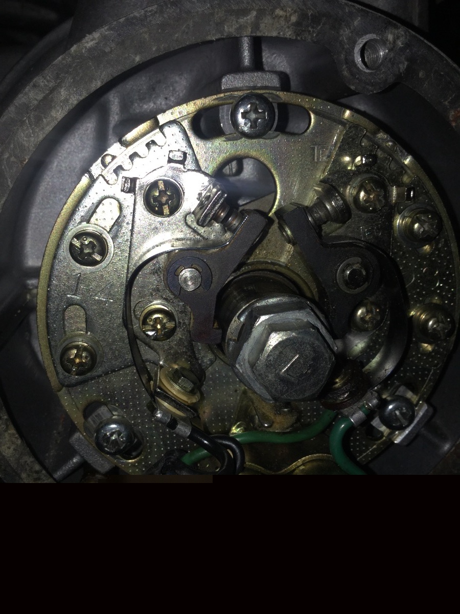

So I got my new point but I cant seem to get the gap within spec. It looks to be about double what its supposed to be and I'm out of adjustments. Is it okay to sand down the lacquered arm where it rides the cam or is there another solution?

Re: timing adjustment using test light
31 Aug 2017 19:01
Don't sand. The issue must be elsewhere. Pic?

- ZoomsJr

31 Aug 2017 21:27
Steve, here's some pics of the points at their widest. If you look closely you can see that only the corner of the rocker makes contact with the cam. I think this may be where the issue lies
01 Sep 2017 05:08
Set them to when the light goes out at the F mark and see what happens.
01 Sep 2017 05:14 - 01 Sep 2017 05:14
It looks to me like there is no problem other than the fact that you need to adjust them. They look like the gap is greater than spec - use a feeler gauge to set them. It looks like you will need to may need to turn the backplate counter clockwise to get the points plates adjusted properly - no biggie. Ed
