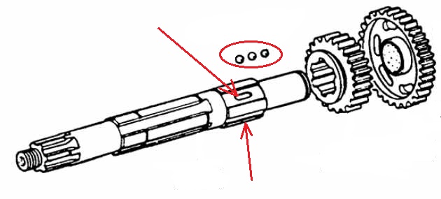

The output shaft has to be spinning fast enough to throw all three ball bearings out of their slots in order to do that.

TexasKZ is correct. The transmission is not suppose to shift into upper gears unless the output shaft is spinning fast enough to throw the 3 balls out of their slots. You can see the balls and 2 of their slots in the diagram below. Ed

Kawasaki marketed that feature as a "Positive Neutral Finder". At a standstill in 1st. gear, lift the shifter and you're in neutral; it can't pass through to second unless the bike's moving faster than about a slow walk.
If you didn't split the cases it should be OK.
