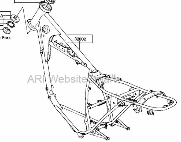

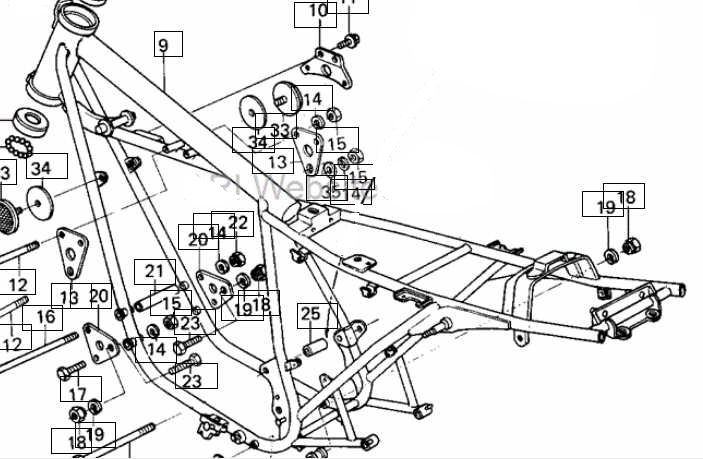

There are more than 1,000 parts for the KZ250 on eBay. Look there to see if they have what you need.
Regarding putting a KZ400 engine in a KZ250 frame - well given enough money, time, and engineering prowess I suppose it could be done. I once put a BSA 500 twin engine in a BSA 350 single frame - but I wouldn't do it again. Take a look at the two images below and you will see that the KZ250 and KZ400 frames are VERY different. Ed
KZ250
KZ400
KZ250
