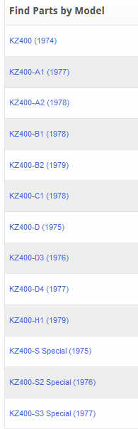

In your signature line please show your bike's exact year and model (see image below). That will make it possible for folks to look up parts diagrams and provide better support to you. Ed

Sorry they only made the ltd for a year in 79 I think it's kz 400 h1 ltd thanks
