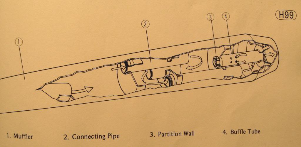

I don't know if the internals of the KZ750 muffler are similar to those of the KZ650, but the KZ650 has quite a bit going on inside. The image below shows what I mean. Ed

That looks like what is going on in my pipes. Do you know if the factory pipes had glass packing in them?

Glass packing? probably not.
My RH muffler broke off completely at the weld. weld C in the pic from eebbaayy.
Here's a 750H muffler system showing one of the baffles. my muffler broke off completely w the baffle still inside of it.
