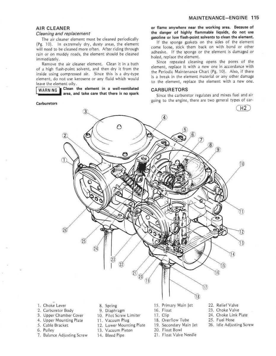

I have a 1981 KZ305 and I do have the manual. After 10mins of running the idle sits at 2000RPM. The throttle cable is fine condition and the idle doesn't change if I move the cable itself. What I can't find is the screw to lower the idle, The Idle Adjustment screw. In my opinion the manual isn't very clear on what I should be adjusting and it doesn't seem to match up to what I have as well. Can anyone give me some advice on how to lower it some?

Pretty sure the black plastic knob on the LH carb is the idle stop screw.

Some carb sets have the idle knob between both carbs
Your carb set has a transmission to the left side for a better access
