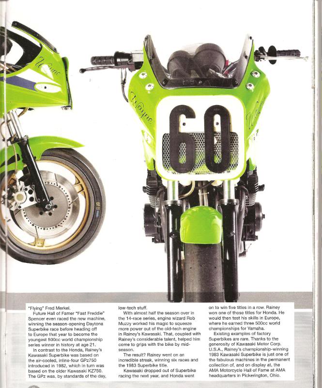

Matt Black radiates heat away best, makes a significant difference...in the lab.
Most cooling for air cooled motorcycles is from the windblast, radiation and convection losses are minimal.
The factory race GPz750 had an oil cooler mounted in the headlamp apeture IIRC to maximise both cylinder head and oil radiator cooling.
