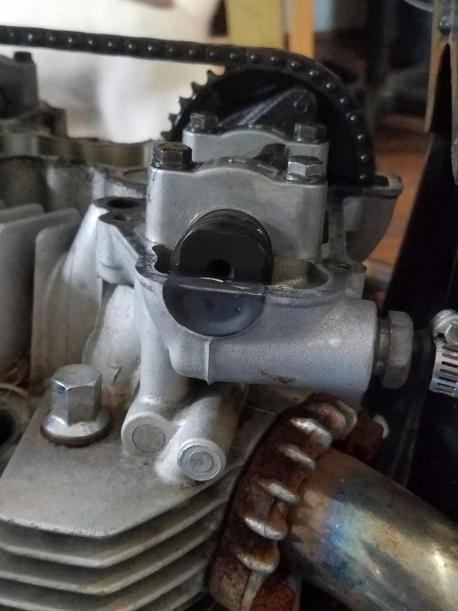

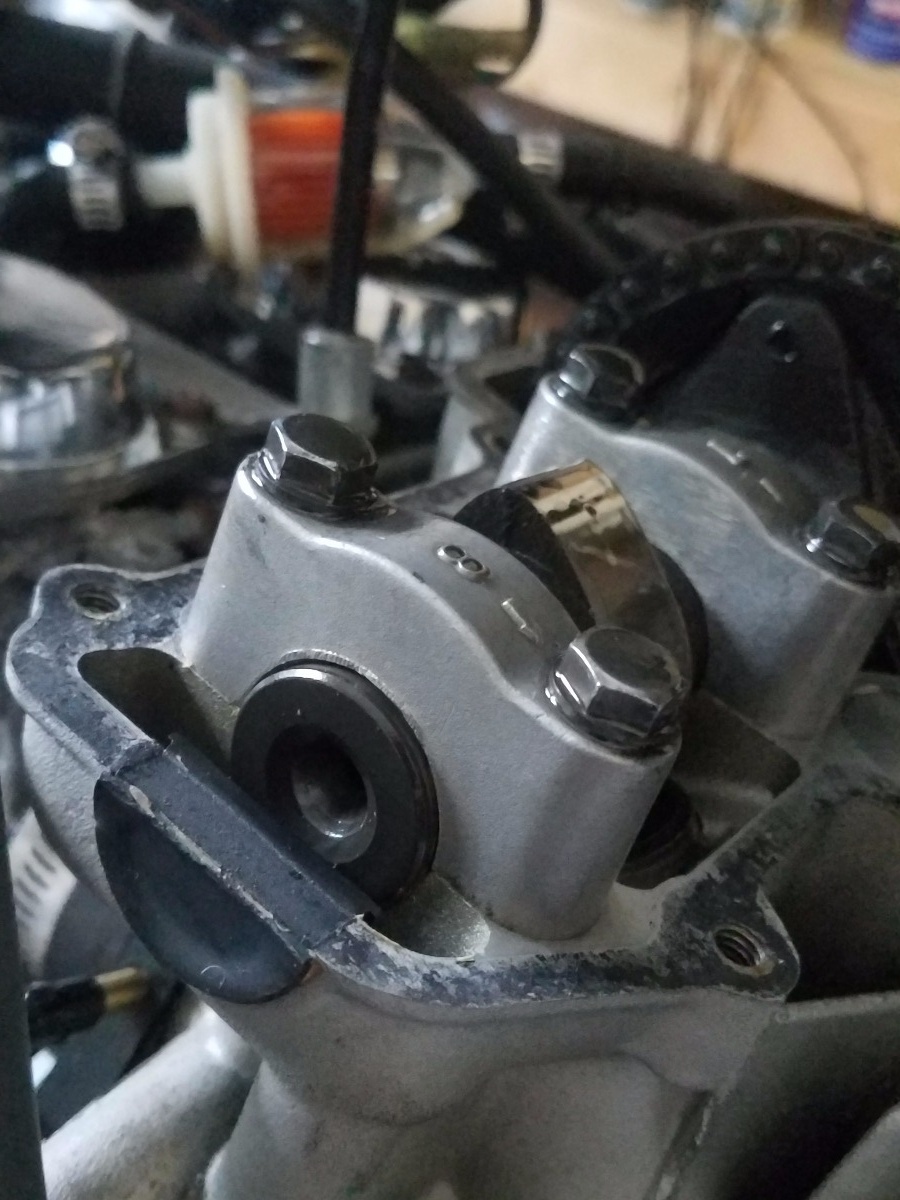

I just measured the valve clearance and this is what I got;
RH exhaust - 0.15 mm
RH intake - less than 0.04 mm (it is the thinnest feeler gauge I have and it will not fit)
LH exhaust - 0.10 mm
LH intake - less than 0.04 mm (it is the thinnest feeler gauge I have and it will not fit)
Just so I understand. When take the shims out I need to use the shim chart in the FSM to determine what size I need to.order.to.get back to spec.
What is the easiest way to get the shims out? I have seen the tool on Z1 website. Will it require me to unbolt the camshaft?
Here is a picture of the camshaft showing the position when i measured the RH intake and exhaust. Just want to make sure I am measuring this

Many will say that you have to position the camshafts exactly as the service manual dictates for checking clearances. While I'm not a believer on that, and would say that lobes pointing away from the follower is good enough, if you are new to the bike, there is nothing wrong with following the (FSM) service manual recommendations to the letter - in fact, you should trust it...
The intakes are below the minimum specified clearance, and you can't get your thinnest feeler gauge in there - PROBLEM!!!!! Maybe the intakes aren't closing at all - you have to address that ASAP. If you bring the intake cam to lobes pointing away, and can't get a 0.04 mm feeler in there - can you spin the shim and bucket easily with your finger? If you can, that would indicate you at least have the valve closed when the engine is cold - so your clearance is (somewhere...) between 0 and 0.04 mm. That might help in finding what size shim you will need by using the chart in the FSM. If you can't spin the shim and bucket easily, then you have no clearance, and will need to get the thinnest shim available to put in there just so you can actually measure the clearance to find what shim should be in there....
It is always better to run valves a little loose vs. too tight....

I should add that the camshafts don't have to come out for the 750 twin. Do get the proper valve depressing tool for your engine.
