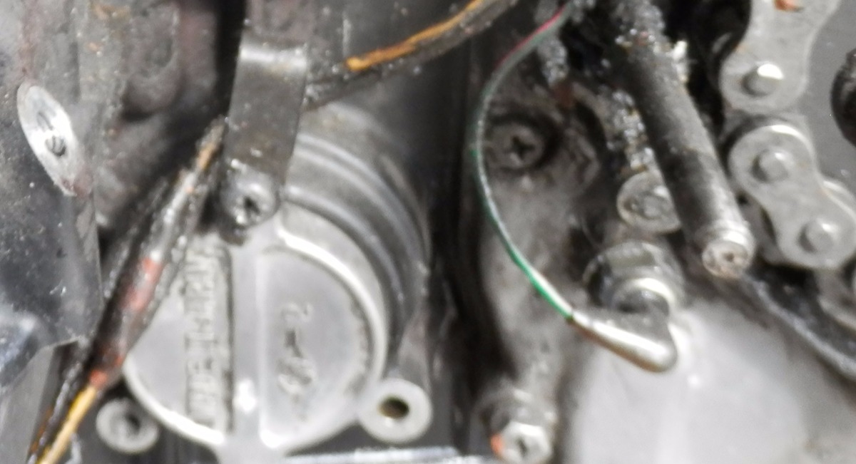

Did you replace the seal/o ring behind the secondary shaft cover ? Its the circular cover to the left of the neutral switch. You can check it without taking the left cover off using a mirror. Wipe off any grime and leave it alone.
I also used a bit of clean cardboard underneath the bike when parked to see where the drop was falling..
If that proves to be your problem then its an easy fix
