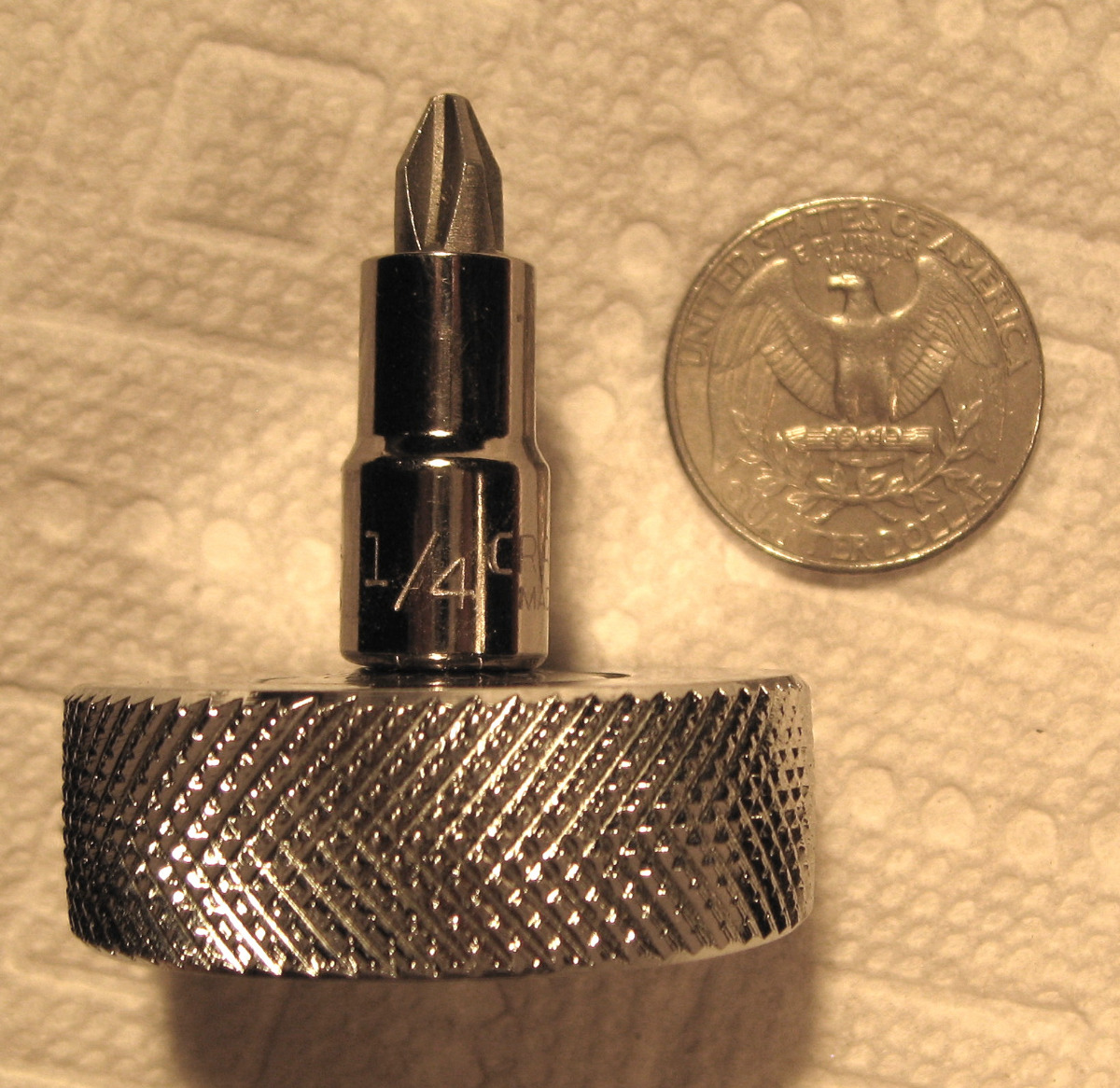

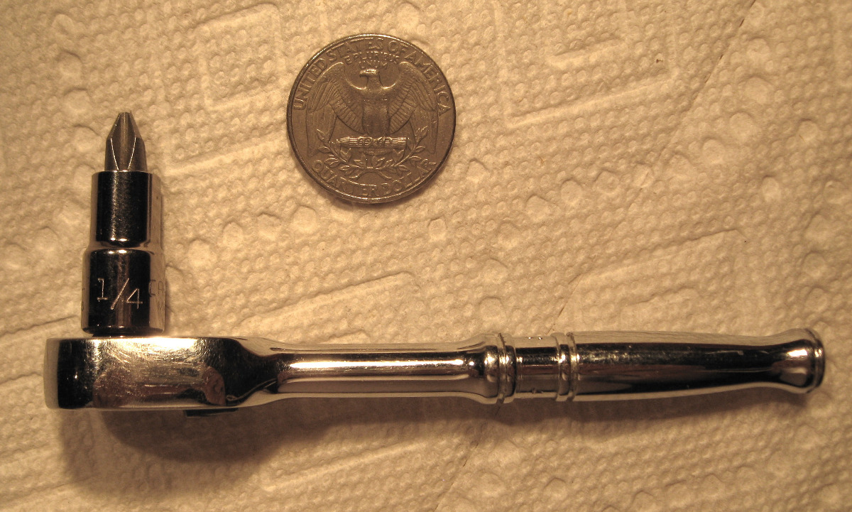

12 Aug 2017 11:58
The carb bowls can be removed and the gaskets replaced with the carbs still on the bike - no problem. The key is to use a very stubby screwdriver or screwdriver bit. I use either of the configurations shown below and it makes life easy. You may also want to use a small hand mirror if you need a bit of help seeing the screws. Ed
