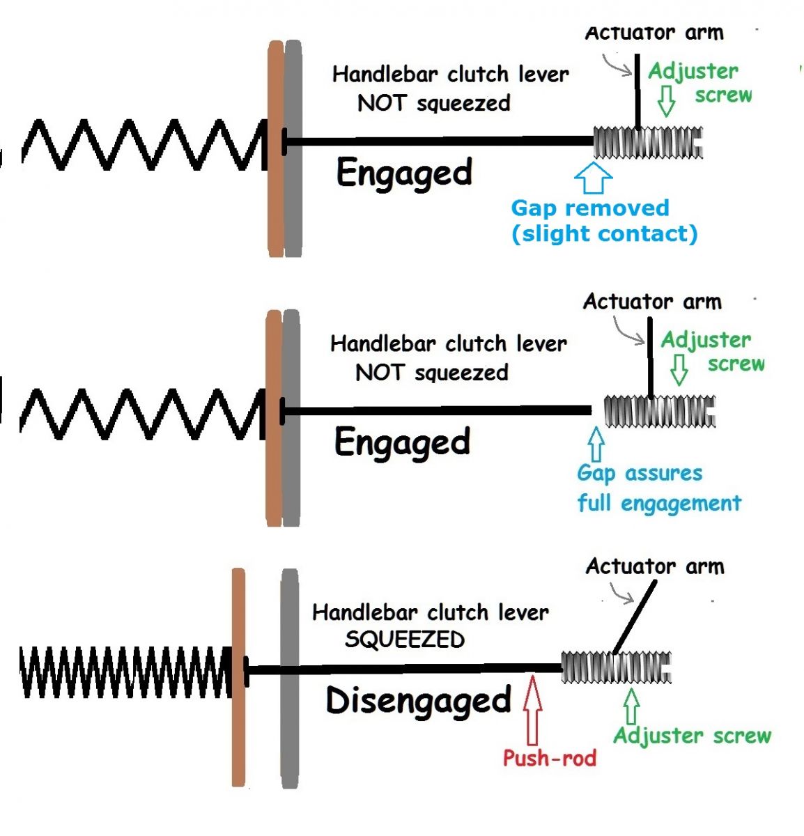

Some service manuals are wrong about which way to first turn the pushrod adjuster screw when initially closing the gap between it and the pushrod before next turning the opposite direction to afford the needed slight gap between it and the pushrod.
If not already done, could try readjusting the pushrod by first turning the pushrod adjuster screw in the opposite direction to that specified in the manual.
The earlier models such as Z1 and KZ900 first turned the screw clockwise to initially close the gap. Which to me seems intuitively correct. Called the screw type adjuster.
Later models adopted the ball and ramp type adjuster on which the screw is first turned counter-clockwise to initially close the gap, next turning clockwise to afford the needed slight gap. Which is correct, but to me seems intuitively weird.
