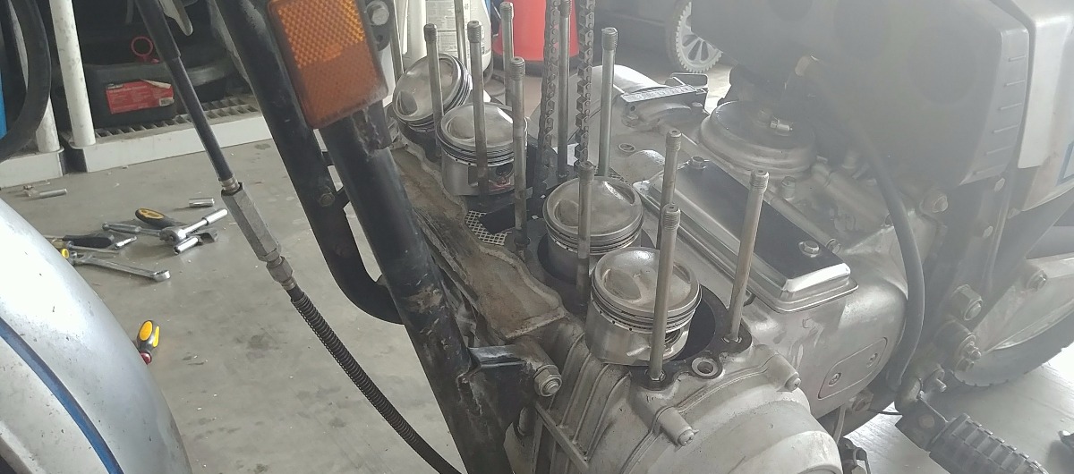

1. Get a good ring compressor or 4. I lodged a hammer into my driveway to prevent myself from lodging it into the cylinders, probably the most difficult and frustrating task was made difficult because I was too cheap to buy ring compressors.

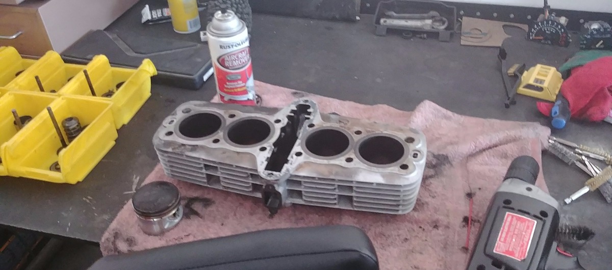

2. The base gasket is hell to remove, and on a lower milage bike you can essentially forget it. Expect all methods to fail and for you to regret pulling the jugs off. My gasket happened to come off perfectly between the jugs and the gasket surface so I used some 3bond type sealant on the gasket face in a very small amount around the face. I do not recommend this nor do i encourage it, I have done so at my own demise. I did not, however, cheap out on the orings. Once those are separated, replace them with Kawasaki parts. Most of mine were flattened and worthless.

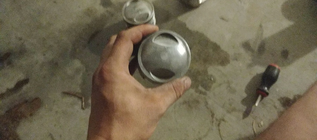

3. Don't cheap out on the Pistons clips either. Pulling them out carefully and comparing them to the new ones you can tell they get heat soaked and shrink, losing there springyness.

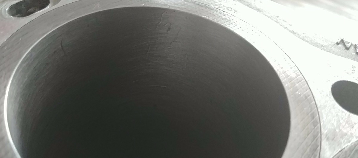

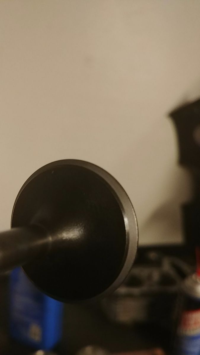

4. For the record, my bike fired up on the first press of the starter button, and despite using atf to lube up the cylinders, did not smoke or pop. I berry honed the jugs to a good crosshatching pattern, and lapped the valves as well.

6. Even on a 6000 mile bike the valve seals were failing. I've replaced them with viton stuff and am glad I did.
