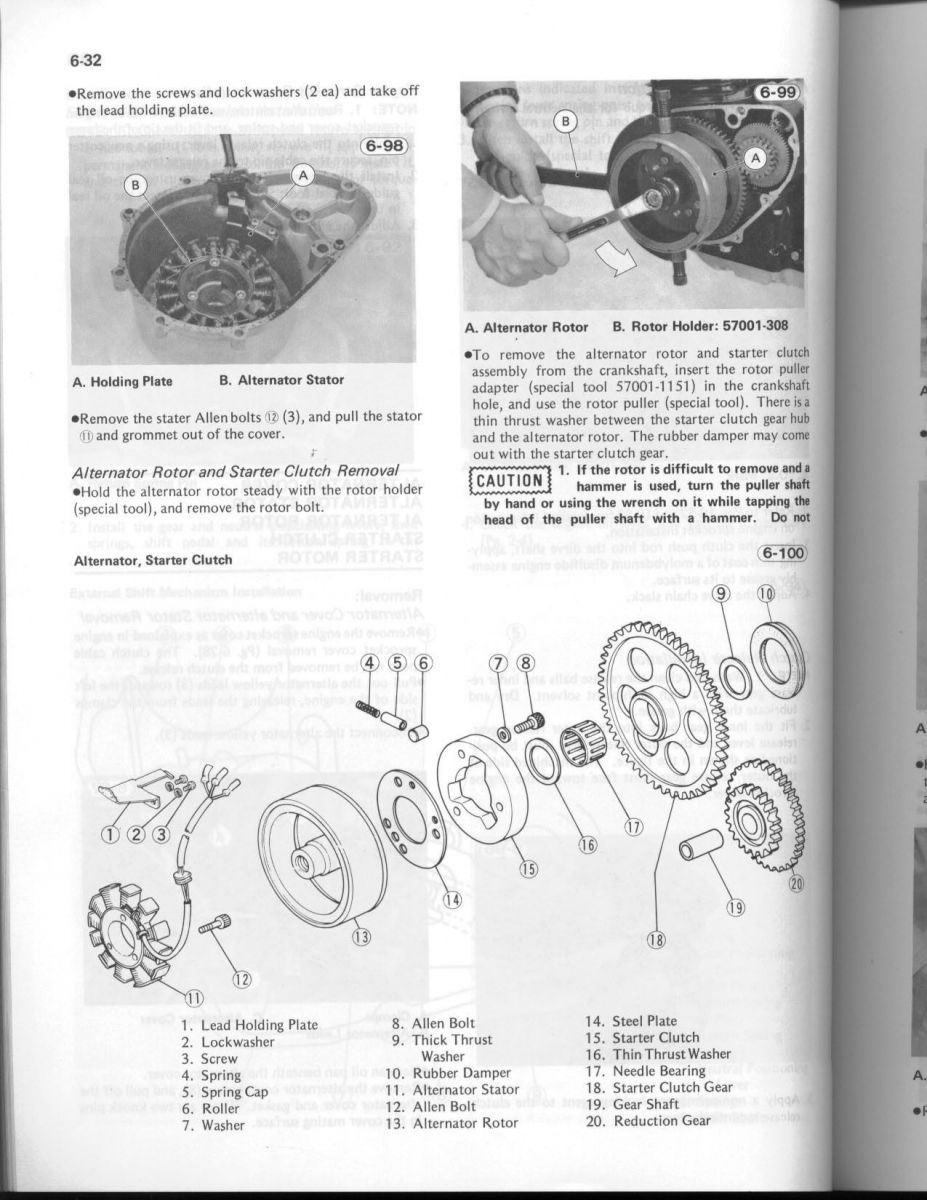

There is a copper washer between the rotor and the drive gear. If it is trapped, it will lock the drive gear and the rotor. You need to check that out. The gas could be timing or valves not sealing.

Also there is a spacer between the large drive gear and the case. The gear has to spin freely, if not the spacer is too thick.

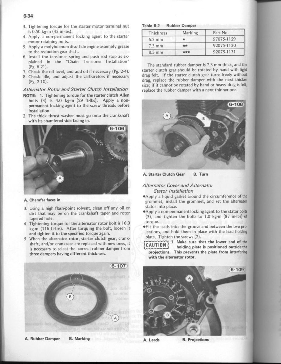

If a J-motor, I believe the rotor bolt (no washer) is supposed to be torqued to 92+ ft. lbs. but you need to verify that with your Kawasaki FSM.
If the rotor is still tight on the crank with the bolt loose, you may have dodged a large bullet or artillery shell.
Steve may be correct about the rubber spacer. The FSM has specifics about that too.

Holy crap on a cracker... found the problem! I popped the alternator part off the crank of the 'parts' engine, saw how everything was supposed to go together, then did the same on my engine. Uh... That copper washer is supposed to go in FRONT of the gear, not behind it! The washer was completely domed out and there was galling between the gear and the alternator (is this the rotor?) piece. Also those little spring-loaded rollers, one of them had a cut spring. So I swapped parts as much as I could, but unfortunately the magnets in the parts engine are destroyed so I still had to use that piece from the new engine. Even with the galling on the one face, once everything was bolted back together the gear still spun freely in only one direction and there was no sloppy sideways movement to it, so I called it good. The galling will probably destroy the copper washer somewhere down the line but it gets me going for now.

A quick view in a service manual will save you a lot of time, frustration and money.
Have you change the rubber washer?? There are three different thickness measuring.

Tell that to the previous owner who put this back together wrong. I never took this apart until today, so I didn't realize there was a problem here. However, reading what it says it appears that what I feel from the gear rotation now is how it *should* be. It spun freely until I torqued down the bolt, then it had just a light drag but still spun smoothly without any wobble.
