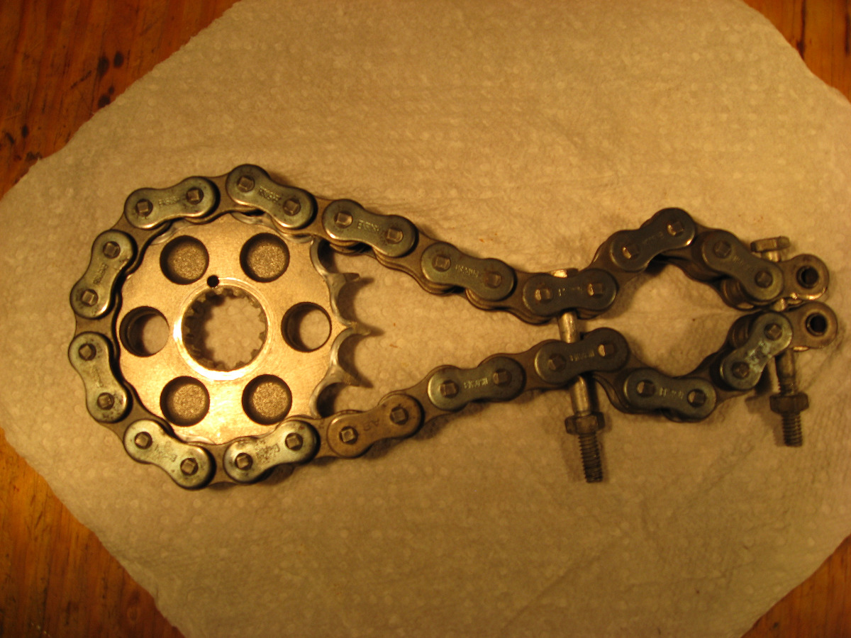

Re: Front sprocket, left or right?!
16 Jul 2017 08:11
Assuming the swing arm is still on the bike if you have an old piece of chain and 2 bolts you can easily make a counter-sprocket holder as shown below. Just wrap the big loop around the sprocket and the small loop around the swingarm pivot and the sprocket will not rotate when you try to loosen or tighten the sprocket nut. Some folks have a friend stand on the brake pedal, but that could cause brake related problems, and some folks stick a pole between the wheel’s spokes which is very hard on the spokes. Using an old length of chain as shown below doesn’t put stress on anything at all and prevents the sprocket from moving when loosening or torquing down the sprocket nut. Ed
16 Jul 2017 11:07
Thanks for the tip, i locked it in a simular way with a Steel rod but sofar no luck.
The rod bent and the Bolt didnt give.
May have to grind it off, hope not!
