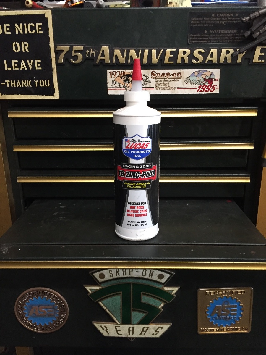

I use Rotella 20/50 and a little Lucas Zinc additive. I use the Zinc on all the air cooled VW's I work on.

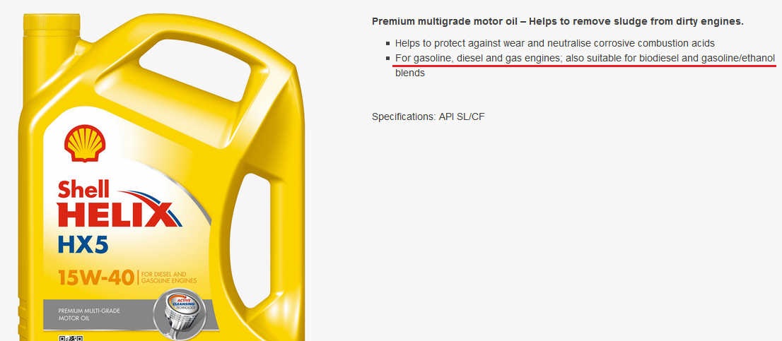

I definitely would NOT use Shell Helix HX5 in my motorcycle. It is NOT JASO-MA certified. The bottle and the Shell website show it is certified to meet "Specifications: API SL/CF". If you use it expect to ruin your bike's clutch. I recommend you simply go to a motorcycle dealer and see what motor oil they use that is JASO-MA certified. Ed

11 Jul 2017 08:02Nessism wrote: I doubt that Helix would hurt your clutch. It's a diesel engine oil and those are almost always a good alternate for over priced motorcycle oil. I've used all different kinds of diesel oil in my bikes over the years and none of them have damaged my clutch in the least.
I don't disagree that diesel oil usually is ok, but Shell Helix is for diesel and gasoline engines, so I would be concerned. I'm sure a motorcycle shop would be able to provide advise regarding what oils are available in the local area for bikes. I'm sure there are JASO-MA oils available there, such as Shell Rotella-6, that are not very expensive. Ed
