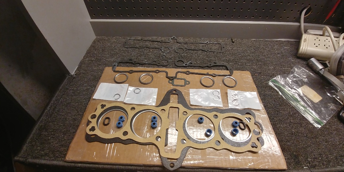

Here is a quick photo of all the parts I have collected so far to perform my top end rebuild. Am I missing anything? (Besides rings, still waiting on those, as well as cam end plugs as mine are new.) Thanks ahead of time.

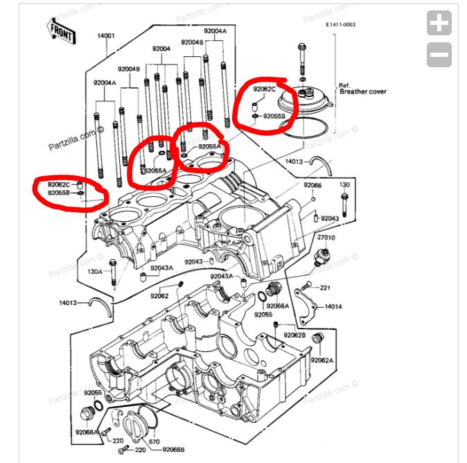

There are some other O-rings. A couple for the cylinder studs. I'd rebuild the cam chain tensioner so there are some seals involved, and get a new seal for the tach drive along with the O-ring.

Thank you for the reply. I have my tach blocked off with a fabbed up block off plate. As for the stud orings, I have a metric kit of orings that I intended to compare fitments. If not I suppose I'll be looking for that part number.
