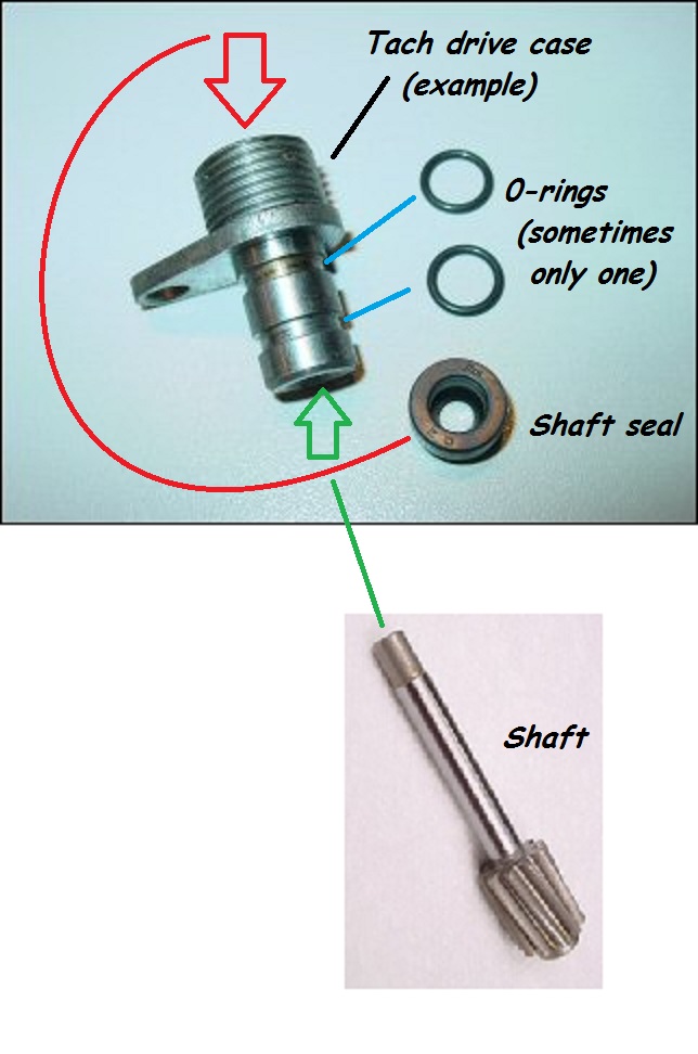

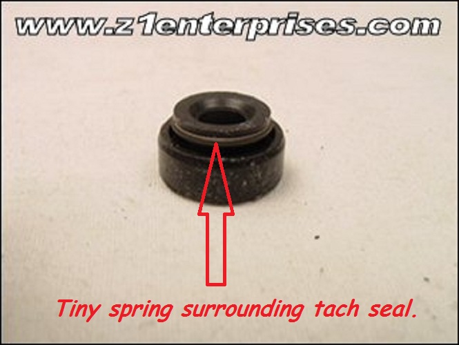

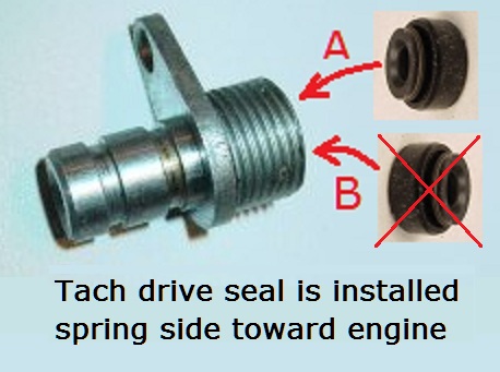

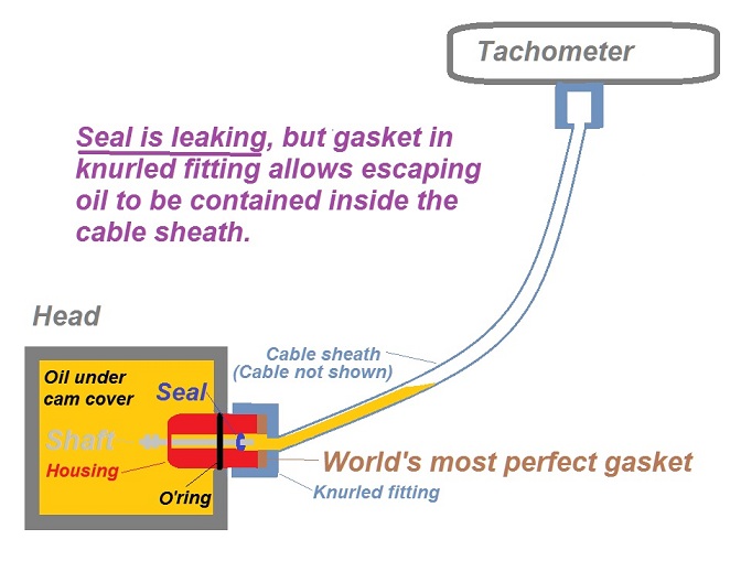

Patton wrote: A leak-proof connection of the tach cable at the tach drive housing will allow leakage past the inner shaft seal to collect within the cable sheath.
Any leakage past the o'ring(s) around the tach drive housing doesn't enter the cable sheath, so it goes onto the fins.
Ideally, the inner shaft seal should prevent escape of any oil whatsoever through the tach housing, even without the cable being attached. And the o'ring(s) should prevent escape of any oil around the tach housing.
The inner seal is replaceable, as the old leaking seals have gotten hard and crusty (likely requiring a dental pick style tool to dig out and remove all remnants of the old seal.)
Without the tach cable attached, a cross country ride should be possible without any leakage through or around the tach housing. Without the cable attached, it's possible to see the spinning end of the inner shaft, which is supposed to stay completely dry and leak-free.
