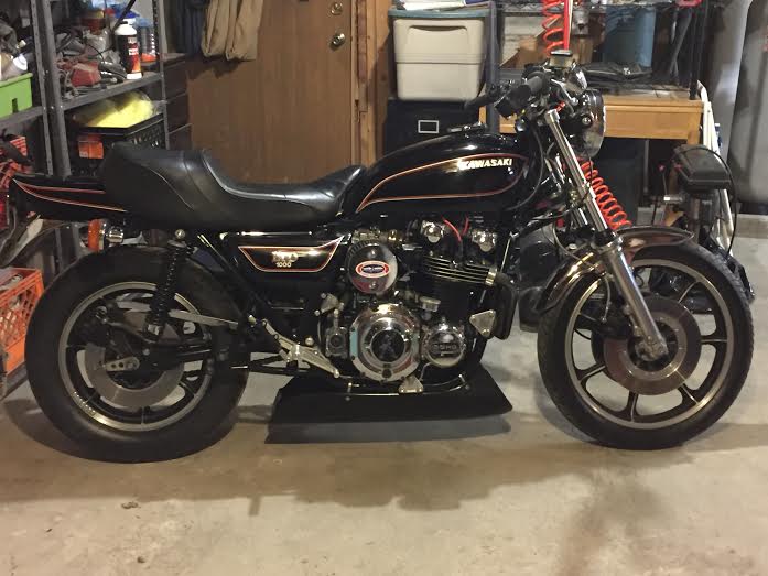

Here is what 200 + HP looks like
Why 140 HP ? Whats magic about this number ?
Do you want a fun daily driver to do some blasting around town or is it 90 percent race and 10 percent driving to the race ?
Horsepower creates heat . Are you prepared to lose street-ability ?
Most guys are more than pleased with a 4 into 1 header , Good tuneup and stiffer drive gearing . Adding teeth to the rear sprocket or dropping teeth on the front counter shaft sprocket will make the bike super quick out of the hole for drag racing .
Im more than happy to tell you who does good work and where and what to buy to go fast .
But what are you trying to achieve ??? Fun ? Bragging rights ? Dyno shootout numbers
Just want to help you , but need these points cleared up
