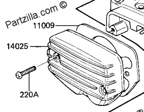

I'm pretty sure this is the cover you need. You'll also need the gasket, which is really easy to find on ebay - oh, and the screws.
KzGod wrote: Does anybody know where I can get that cover?

Parts diagrams can be found on line for free. I typically use Partzilla. You can find several useful pieces of information that will help in your search. You can get the part number, Price, availability and a list of what models it was used on. This can all be useful for an Ebay search. You'll know if it's compatible if you find one from a newer/older model year. Some common items were used across 20 -30 models over a 10 year span.
In your case, the part number is 14031-1018 and it is no longer available from a dealer. It looks like it was only used on the 81-82 305 models.
PRODUCT OBSOLETE
This Kawasaki 14031-1018 COVER-GENERATOR,CAP is used on these models and components:
1981 KZ305-A1 CSR ENGINE COVERS (KZ305-A1)
1981 KZ305-A1 CSR ENGINE COVERS (KZ305-A2)
1982 KZ305-A2 CSR ENGINE COVERS (KZ305-A1)
1982 KZ305-A2 CSR ENGINE COVERS (KZ305-A2)
1982 KZ305-B1 CSR Belt ENGINE COVERS
I'm sure you'll find one, but it may take a little digging. Good Luck.

I believe that cover is is actually for the valves on top of the head. Use the pictures in the Parts Diagram to confirm. However, that seller is a known dismantler who parts out bikes on E-Bay. He's obviously parting out a KZ305 engine. You can always ask if he' still has the Points cover you need.I'm pretty sure this is the cover you need. You'll also need the gasket, which is really easy to find on ebay - oh, and the screws.

09 Jun 2017 11:44 - 09 Jun 2017 12:12MDZ1rider wrote: I believe that cover is is actually for the valves on top of the head. .
It looks an awful lot like the points cover to me, just upside down. Unless I'm mistaken, the points assembly on a 305 is on the cam shaft, not the crank shaft, so it is located on the head. The generator cover is a different thing.

09 Jun 2017 12:41
You could be right. I've never seen or touched a KZ305 and I assumed the points were in the same location as the bigger KZ's. The seller's description also said it was a valve cover. Ya' learn something new everyday. The OP should be able to use the diagram pictures to determine what he needs.
