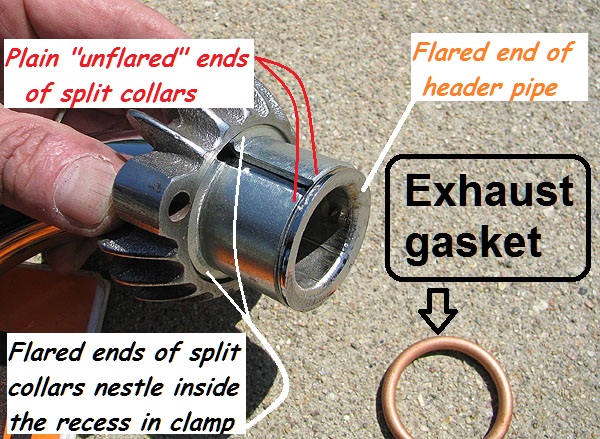

patton has posted an image around here somewhere.
gaskets first -- then header pipes -- half-moon exhaust collars (small ends against header pipe flanges) -- exhaust holders
or a different way to look at it:
exhaust holders -->> half-moon collars -->> header pipes -->> gaskets -->> engine exhaust ports

Re: 83 KZ750 F1 Exhaust Collars - purpose?
02 Jun 2017 12:54 - 02 Jun 2017 13:00
Last edit: 02 Jun 2017 13:00 by Patton.
The following user(s) said Thank You: GPz550D1, skilledman101
