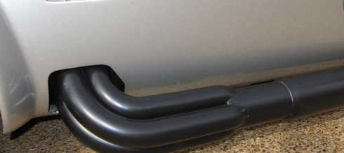

I used Rustoleum ultra bar-b-que grill paint on the manifold section of my muffler system & it's still good after a few thousand miles. Since the chrome was in very good condition, I just hit the rusty areas with jewelers brass wire wheels. I was expecting the paint to get burned off the shiny chrome, but it's still intact. see pic.
In your case I would probably sand the pipes with emory cloth before painting.
