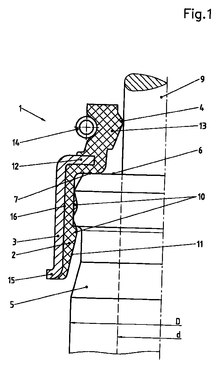

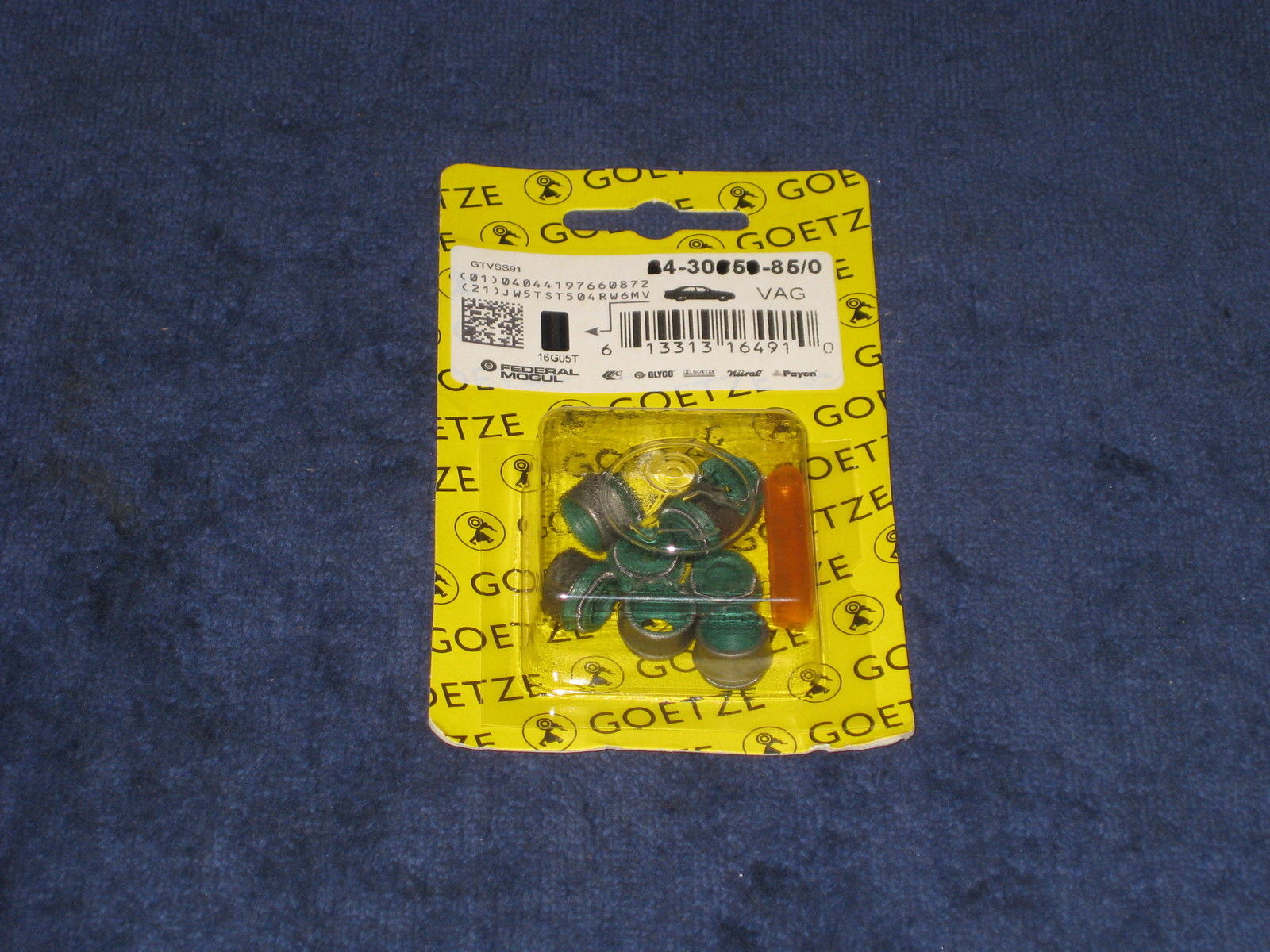

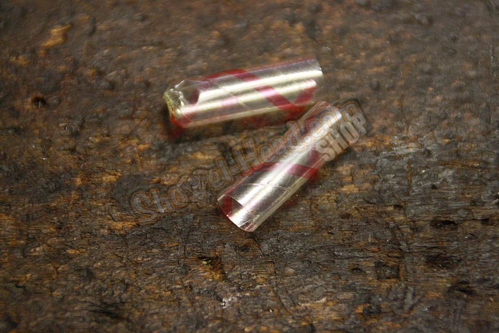

Your withe smoke can be unburned fuel or oil.
You changed valve stem gaskets,are you sure you do it right??
You can easily damage the sealing lip #4 if you not use a special tube to prevent the sealing lip
scratched by the valve stem grove for the valve keepers.
The tubes were put on the valve stem to prevent any damage of the sealing lip of the valve stem gasket (little o-rings)
The valve stem seals are sensitive by sharp edges and can destroy easily.
This then cause the with smoke by unburned oil that is leaking through the valve stem guide into the combustion chamber.
These tubes are normally in every set of valve stem seals.
