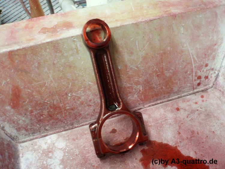

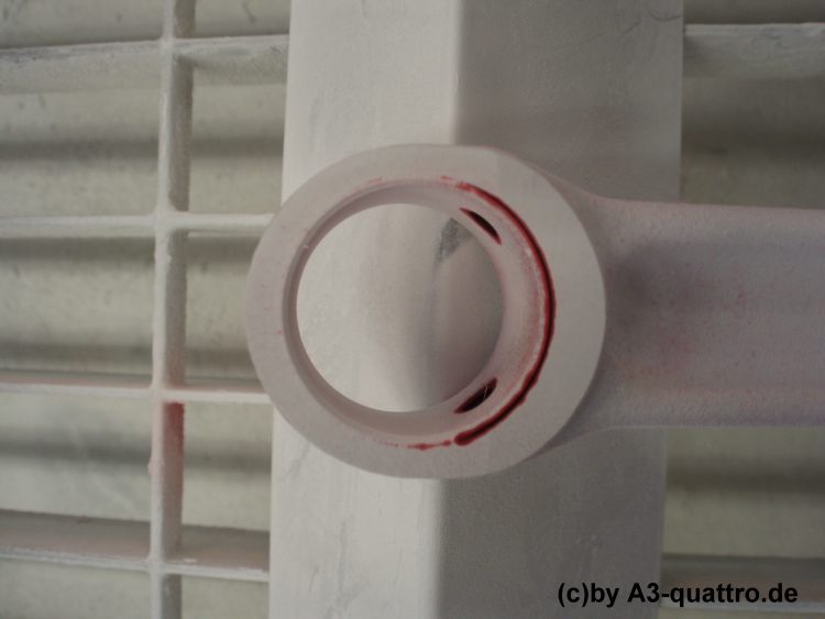

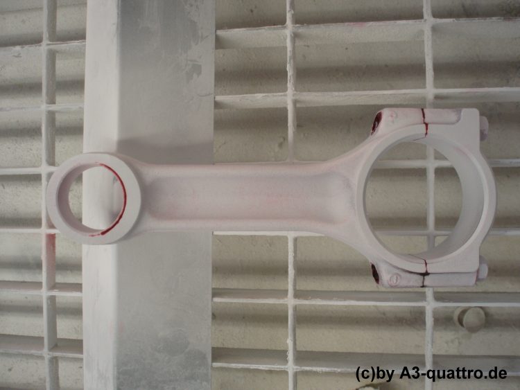

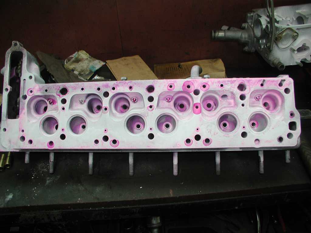

You can do some crack test in the suspect and degrease area.
In my company we checked suspected rollers surface condition ( for cold rolling mills ) for hidden cracks.
Color RED sprayed on to penetrate the crack, then wipe away after 3 minutes.
Color WHITE sprayed on as a contrast medium, RED penetrate out of the crack and discolored WITHE.
Crack found, Bingo
