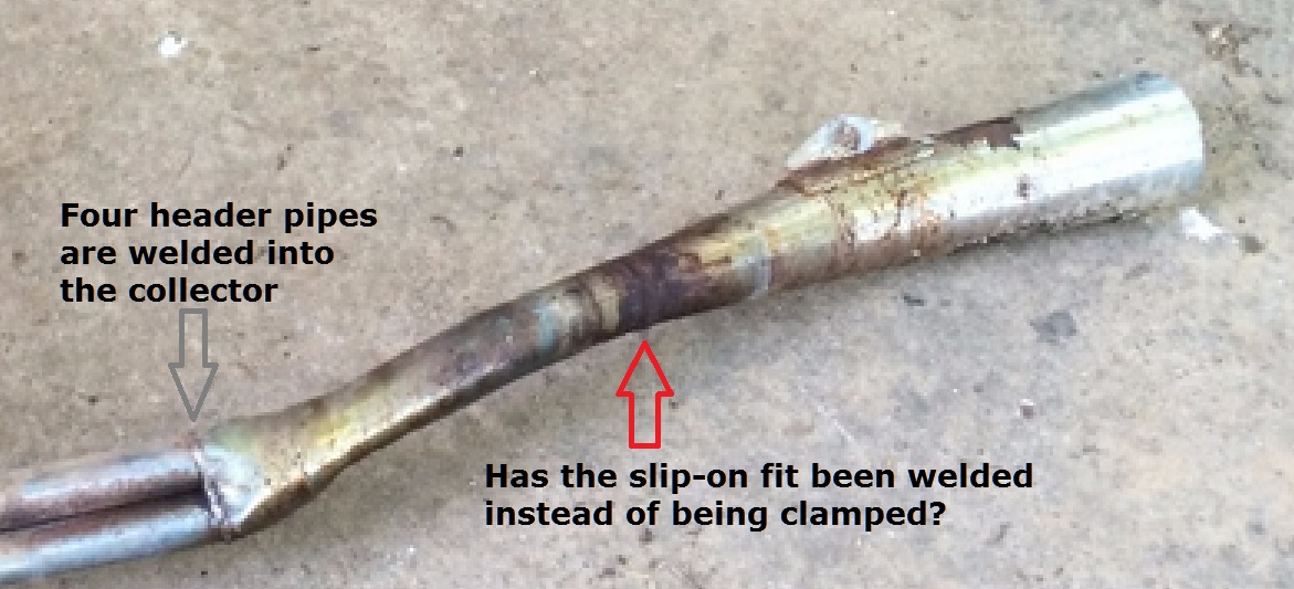

Hey guys, I am completely new to the forum. I recently purchased a kz1100 and I'm working on getting it up and running again. Currently it has a 4 into 1 Kerker exhaust and the muffler on the kerker looks terrible. I was wanting to replace it with a slip on, but the muffler is welded to the head pipe. I should also mention I am a total newbie and this is the first mechanical type project I have ever done. Any suggestions on being able to replace that muffler?

How about a pic of the other side and a pic of where it's welded.

Yes. Rather than being clamped it is welded and I want to change it. I'm just curious what the best approach would be.

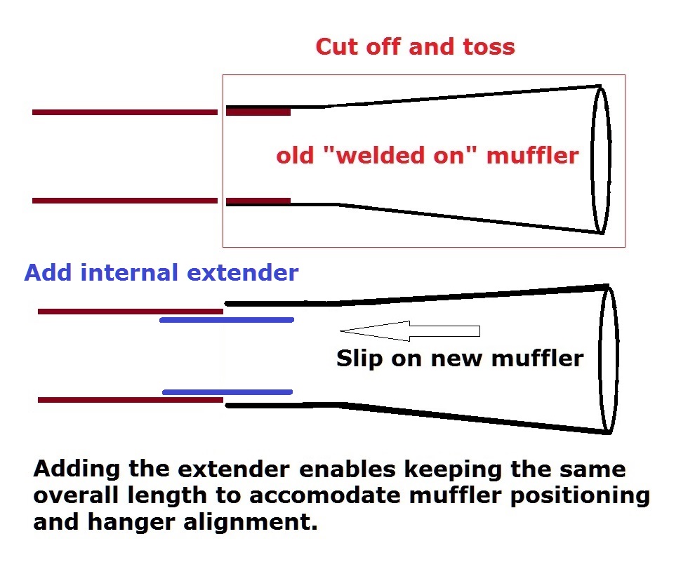

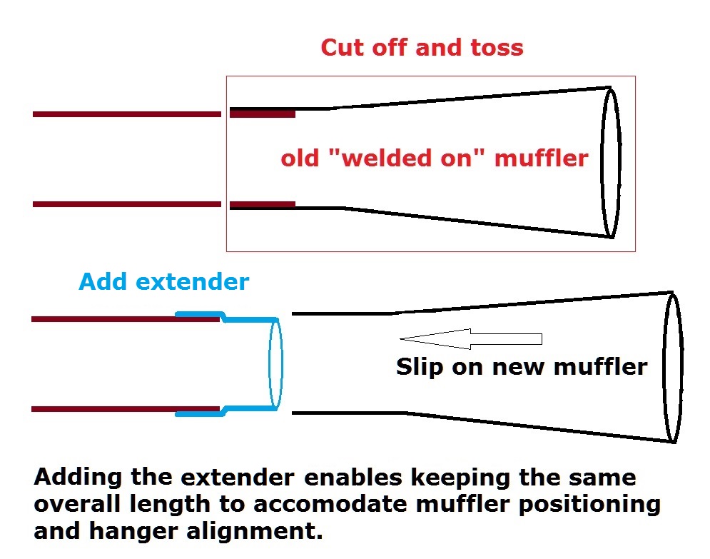

Possibly cut off the muffler and add an extender to attach a new muffler.

25 Apr 2017 05:48 - 25 Apr 2017 05:57An extender might be available at an auto parts store, but the best bet is probably a muffler shop.
The muffler shop guys may be willing to cut off the old muffler as well as prepare an appropriate size extender.
In any event, both the header (collector) and old muffler should be on hand for measuring incident to preparation of an appropriately sized extender.

Hack-sawing off the muffler will unavoidably take some of the collector with it, thereby shortening the length of the collector.
Perhaps find a section of pipe having an outside diameter that fits snugly into the collector and protrudes enough to accept the new muffler.
Could apply high temp copper sealant to semi-permanently seal and secure the section of pipe where it fits into the collector, which basically extends the collector with an effectively smaller o.d., which protruding extension will require shimming wrap or packing (or some other heat-resistant material) to achieve a snug fit into the new muffler.
Do NOT use sealant where the muffler connects, because the muffler needs to remain adjustable back and forth and rotationally in order to achieve correct positioning for chassis and hanger compatibility, and to be removable. That's the purpose for the clamp.
