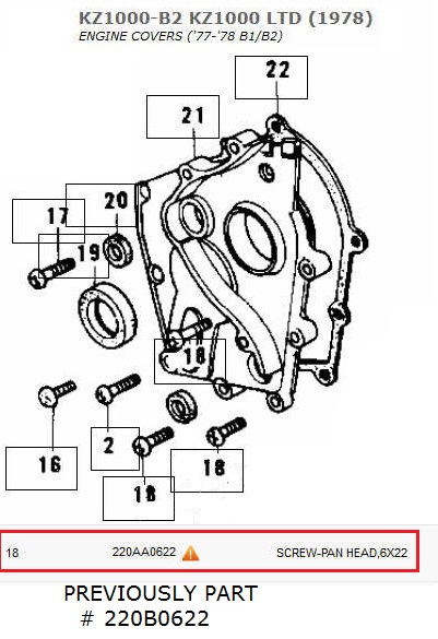

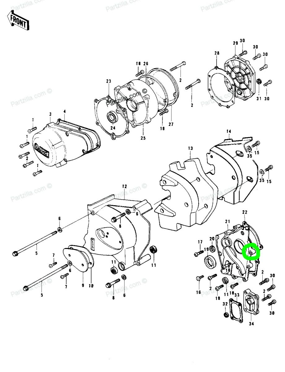

Hello,
One of my parts is not genuine and ii want to replace it by the good one.
But i'm not sure of the size of the screw.
In attachement a picture of the missing screw and a partzilla link.
If someone is sure of the number part or even know it, could you confirm me the correct part number please?

I looks like the screw in question is one of the ones marked #18. That would be part number 220AA0622 (previously 220B0622). That is a 6mm screw that is 22mm long. I believe it is still available from Kawasaki. Ed

This one is too small at this place...
I think the number 18 are the ones for the corner.
The number 2 : 220AA0640 SCREW-PAN HEAD,6X40
look to be the good one at this place...

If i ask that is because i suspect to have a thread problem at this place...
I would like to know the correct size screw to be sure that the thread is not broken on a long way inside...
If it's the 220AA0640 part that means i can go to screw to search the good thread...
I don't want to screw and go too long, or broke the screw inside....
