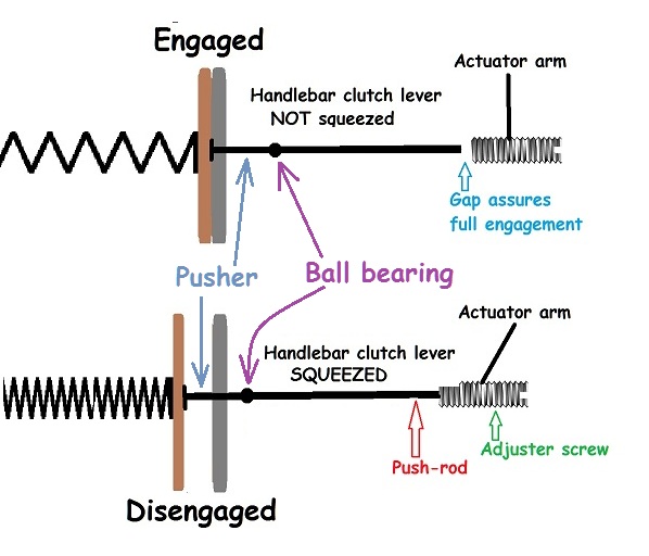

Perhaps the little ball bearing went awol.
See part 21 in the diagram via the following link:
Click here > www.kawasaki.com/Parts/PartsDiagram/142988/1980/KZ440-B1

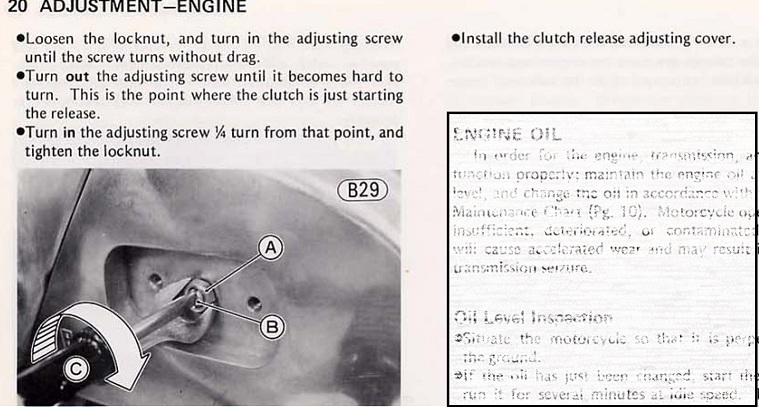

Had you ever adjusted the clutch release mechanism & cable before? and does the owner's manual say specifically which direction to turn the clutch release adjusting screws? On some models you're supposed to turn it counterclockwise first until hard to turn, then clockwise a 1/4 or 1/2 turn. My 650-csr om specifically says counterclockwise first & then 1/4 clockwise. I think most 440s are the same. not sure about the 1980 440, though.

Some manuals are ambiguous & don't specify the direction to turn the adjusting screw.
On some models it's clockwise first. on others it's counterclockwise first.

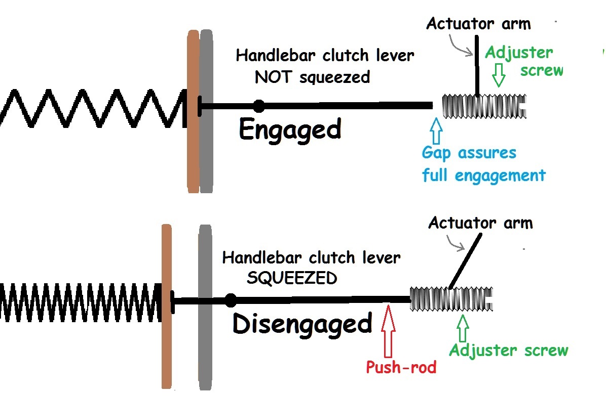

And if the adjustment function seems to fail, it's okay to try again by reversing the rotation directions.
As I recall, there is at least one FSM that provides incorrect instructions.
The idea is to first close the gap between the push rod and adjuster screw.
And then add a slight gap to assure full engagement in normal running position.
