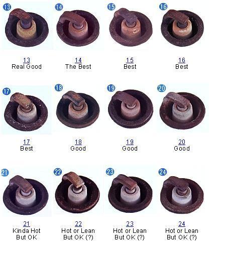

Some pictures of your spark plugs are a great help for us.

scirocco, here are the spark plugs they are in order as they would be on the bike going from outside left to outside right. I dont know if it means anything but when i pulled on out smoke came out too but just for one. And also i am hearing a little knocking noise too.
