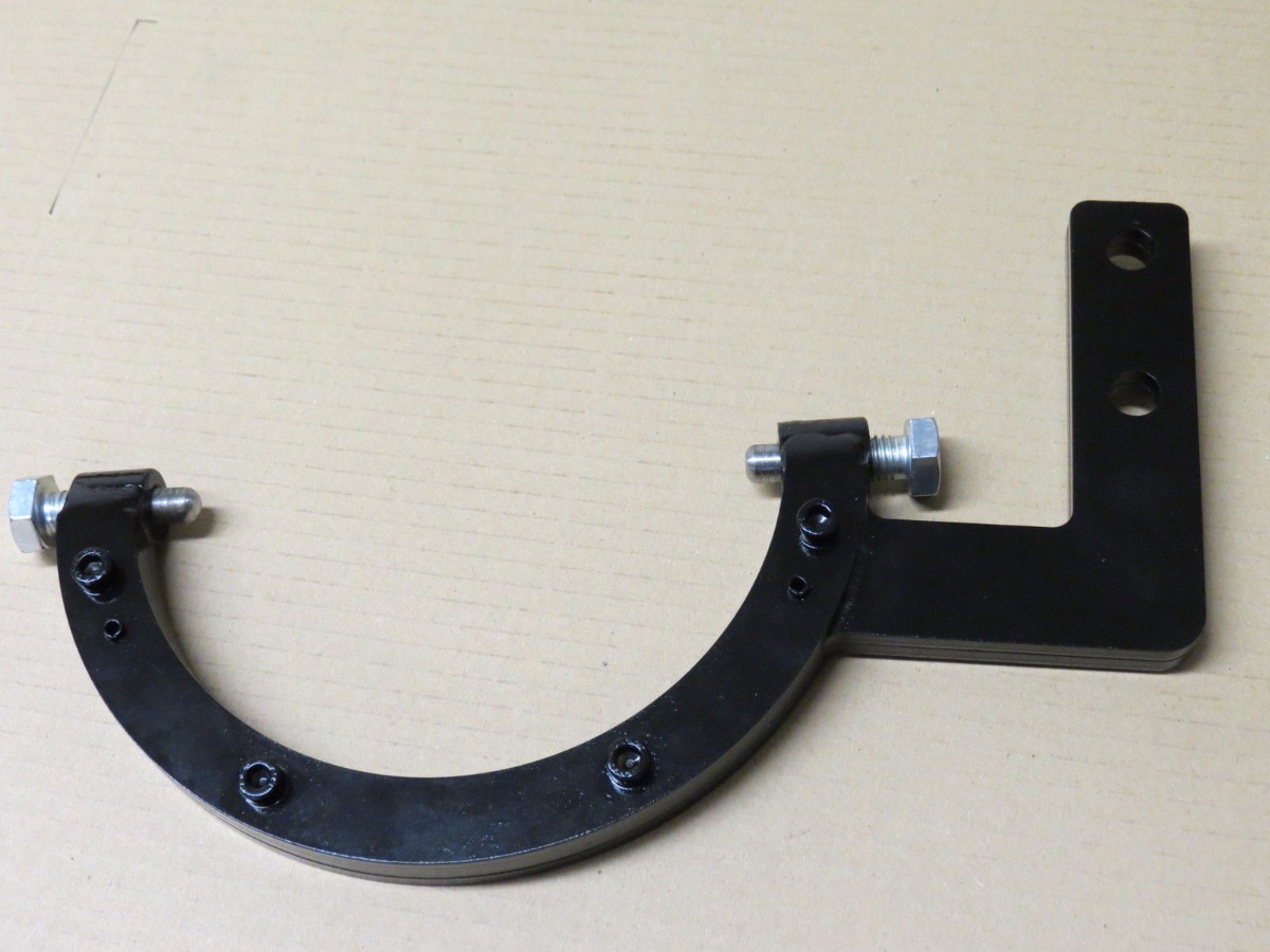

Unfortunately the "special tool' that's supposed to be used can no longer be purchased and would have to be custom made. I bought raw leather laces from a shoe store specifically for the job. To put the clutch pins assembly on and torque the bolts down I was pretty clever; my large vice has screws holding the grips in place, and removed two of the screws opposite each other and replaced them with a pair of pieces of threaded rod....worked like a charm for holding the rotor in place. Lets see if I can get a picture:
The rotor was very wobbly, and I couldn't 'clamp' down on it or the magnets would break. I could've stuck a piece of wood to stop it from wobbling all over the place now that I think about it. Hopefully this idea helps somebody out there.
