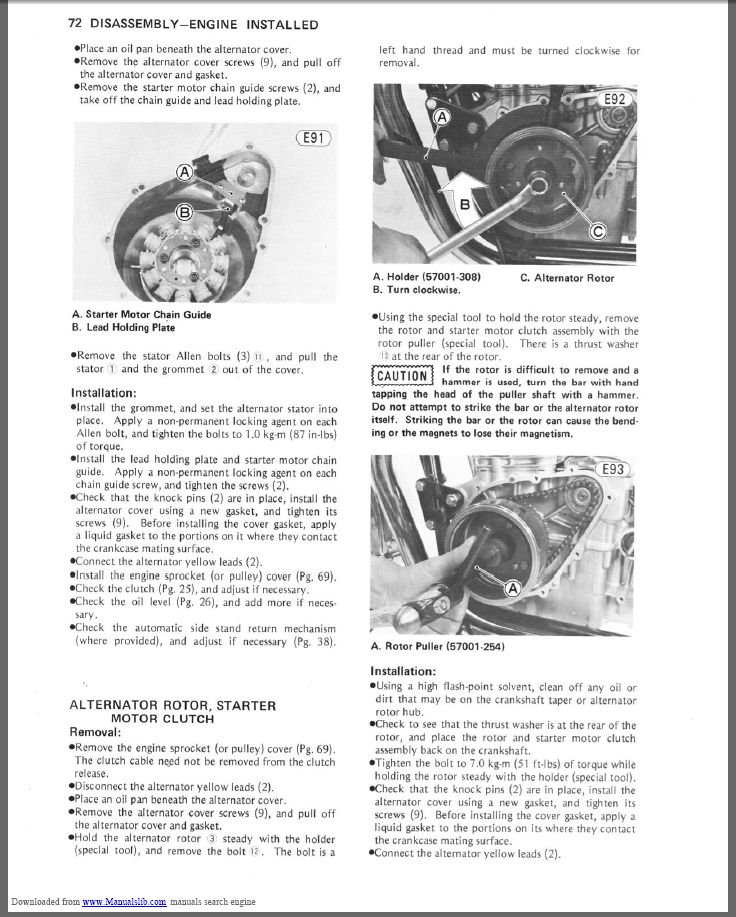

Question, KZ440 alternator rotor, is the bolt standard thread or do I tighten to loosen???

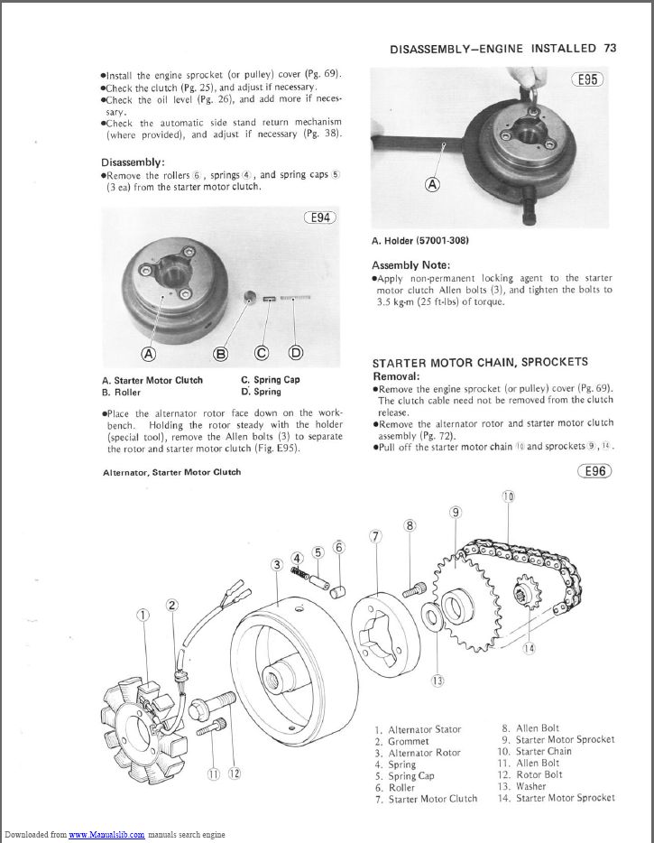

hello
The bolt is a left hand threat, ( turn clockwise to loosen the bolt )
