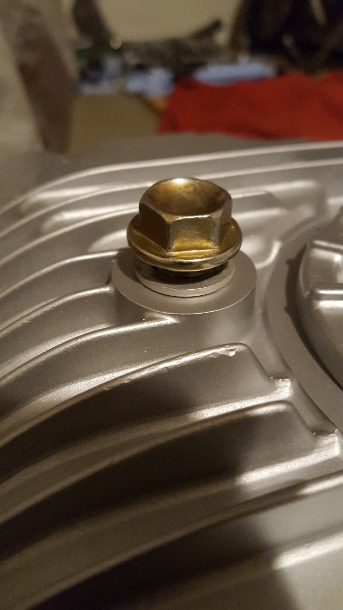

Not sure what happened here. Turned ratchet counter clockwise to remove oil drain plug and it stripped and is spinning in both directions now. WTF. It almost looks like it was being screwed in based on my view of the crush washer.
My local shop said they can drill out the bolt to remove it, re-tap the hole (not sure what they do here - perhaps someone can comment) and put in a new washer/ bolt and it will be as good a new.
I wanted to post this to confirm what I have been told is good and in case anyone has any tips for this work. Bike is going in tomorrow.
