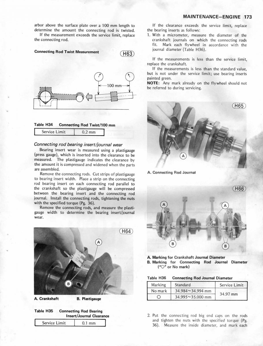

hey can anyone tell me what the bearing clearance is where the connecting rod meets the crank? i just need to know what size plastigauge to use and i cant find the spec anywhere and to make things worse the FSM i have does not say (the scanner cut off the part of the page with that info)
**edit: i need the spec for my 1981 kz750 four**
if anyone has a better quality manual, the spec should be on page 173 in table H35
