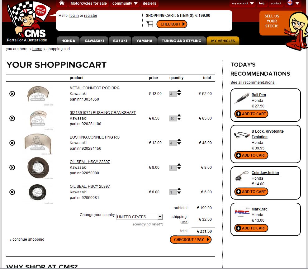

I think I might have found a site that has them and some sites I looked at show part number has changed to PN. Site is below. Looks like they still have quite a few items in stock for this bike, more than I have found at other sites. They are oversees, but if they have the parts I need I am happy.
www.cmsnl.com/kawasaki-kz750n2-spectre-1...list/?model_q=kz750n
Re: 750 Spectre rebuild
28 Mar 2017 14:03
Quick shopping list if necessary
Take some pics of your rod / crankshaft bushings and crankshaft surfaces to check if all parts are needed.
Michael
Michael
