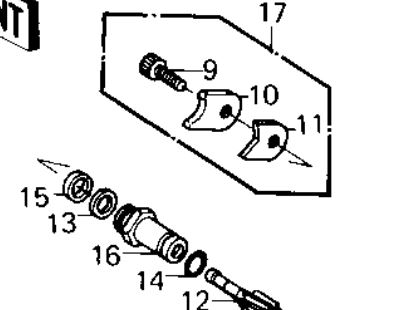

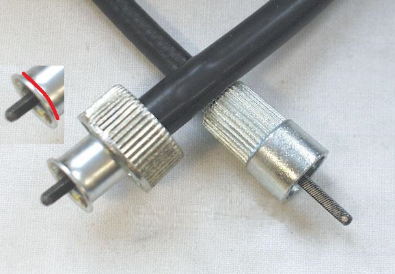

Did the nut get damaged from bottoming out? What's the cable part # ? ..... my cable nut is 11 mm deep (motion pro).
There should be a tach drive seal & gasket. The tach holder allen bolt is missing.
A photo of the tachometer drive might help. You could remove the cable & compare the tach drive to eebbaayy photos.
maybe you ordered or received the wrong cable. or motion pro goofed & put the wrong nut on it. ???

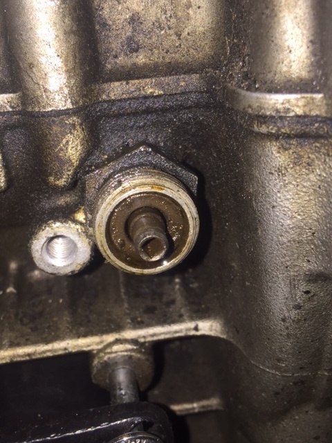

Great suggestions everyone, thanks. Here is a picture of the tach drive. It does appear that I'm missing the gasket and oring. That would explain what's going on. Has anyone fab'd anything here or do I need to go OEM (if available)?

I don't think the oil seal will have any effect on the cable nut bottoming out.
The gasket fits between the tach drive & cable end, so that will account for a little offset.
Lacking a gasket, you could try a washer to see if the cable nut will fit right. 16mm od
You could probably substitute a fiber washer or aluminum gasket/washer for the oem gasket.

Advice taken. Put a fiber washer in there and the cable tightens up with the mount in place. OEM parts ordered so I can complete the repair correctly. Assuming the OEM stuff accounts for the same thickness I'm in business.
Thanks everyone!
