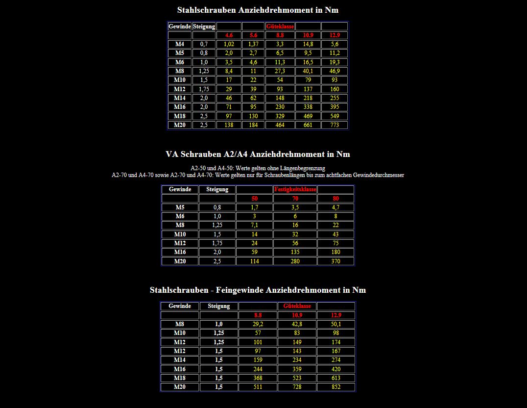

www.sellifighter.de/technik/GEWINDE/GEWINDE.HTM
torque specs for Metric threads
strength class
Translations
Gewinde = threads
Feingewinde = fine thread
Steigung = thread pitch
Güteklasse / Festigkeitsklasse = grade, strength class ( 8.8 standard grade)
Stahlschrauben = steel screws
VA Schrauben A2/A4 = stainless screws
Anziehdrehmoment in Nm = torque Nm
strength class
Translations
Gewinde = threads
