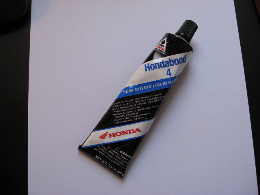

As far as a liquid gasket - there are very few places that is required on a KZ650 engine. The one place I have seen it specified is on a small section of the clutch cover gasket where it spans a seam in the engine cases. For that I use Hondabond 4 semi-drying liquid gasket. I believe it is made by "Three Bond" who also makes Yamabond, Kawibond, etc. Ed
