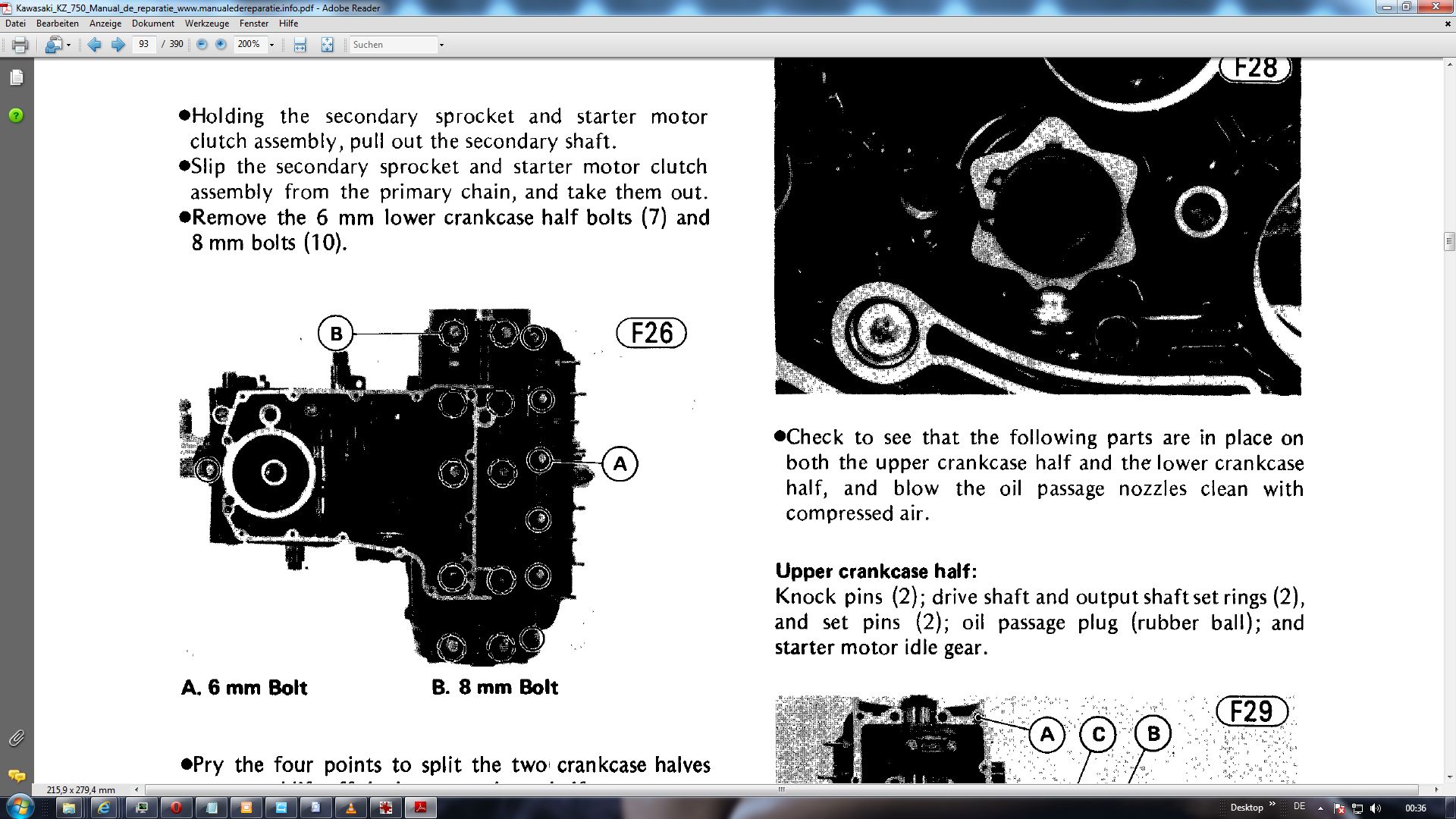

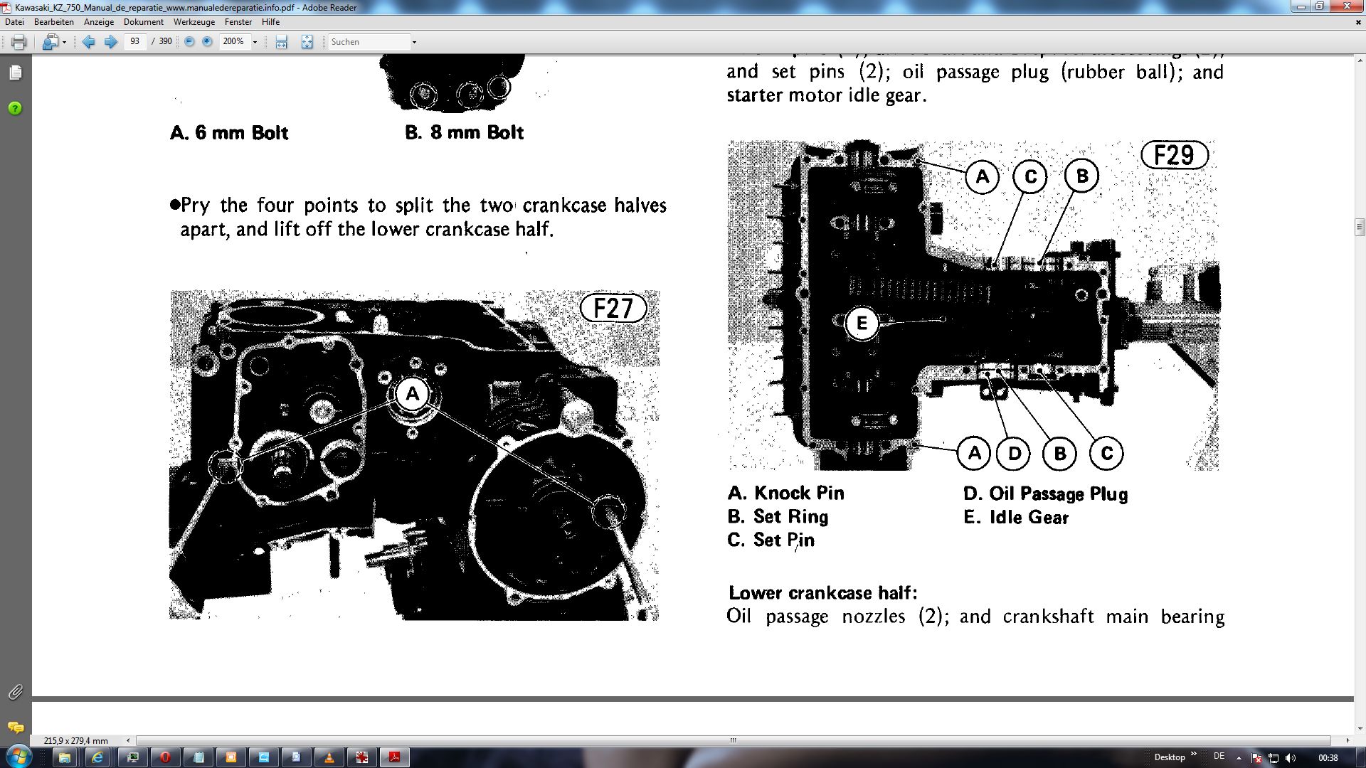

Trying to split the case halves here. I have every screw out that could hold it together. I have the engine pulled so I can access everything. I cannot get them to separate with flat heads in all the pry points! Clutch is off and removed, obviously cylinder and head are both pulled. Pulled the LH inner cover off too behind the countershaft sprocket. Any thoughts? Would heat help?

Hello Hamman
www.manualedereparatie.info/manuale/Kawa...dereparatie.info.zip
Do not use unnecessary force to split your case

Thank you sir, I got it. Forgot the 3 bolts under the oil pan.
